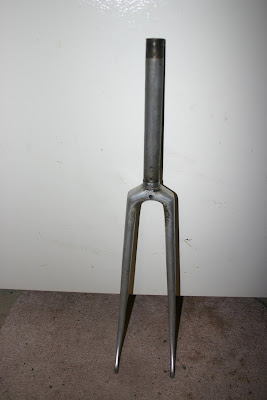

are yours the infamous 'death forks'?

It is indeed - I've been trying to get our lass more excited about cycling by mentioning this to her but to no avail. It is the least deathly of the three different sorts of death fork:

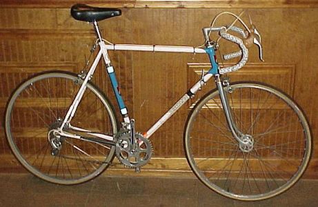

I'll do the spec list as soon as I can, but in the meantime (and with apologies to Bendo, as he'll have seen these pictures twice!) here's some pictures of the Aerospace as it is now - finished, unless I can pick up the few missing odds and ends.

Yes, I think Trusty was the bike company that bought Lambert's assets went Lambert got into trouble, and Viscount was the brand name used. To begin with at least, Aerospaces were constructed from the same tubing, on the same jigs and using many of the same components as top of the line Lamberts. I love the chainwheel too - one of the many things that makes Aerospaces look so distinctive. Anyway, here's the spec list:
Frame: Viscount Aerospace Pro, 23 inches (well, near enough) crank to top of top tube
Fork: Viscount one piece aluminium fork with steel steerer
Headset: I'n not sure, but I think it might be another Viscount bit...
Stem: Viscount aluminium
Handlebar: Viscount / Copal Foundaries aluminium
Bar Tape: Tressorex black cloth
Brake Levers/Brifters: Lambert aluminium, blue anodized pivots
Brake Calipers: Viscount centre pull
Brake Pads: Fibrax
Shifters: Shimano
Front Derailleur: Shimano Titlist
Rear Derailleur: Shimano Crane
Cassette: 15 - 24 5 speed
Chain: Black and greasy
Cranks: Viscount aluminium cotterless
Chainrings: Viscount, 52 / 42
Bottom Bracket: Viscount, press fit sealed bearings
Pedals: Lambert cast aluminium alloy, needle bearing
Rims: Weinmann aluminium
Hubs: Viscount high flange
Hub Skewers: Viscount
Tyres: Panaracer Pasela
Saddle: Brooks B17 Champion Narrow, brown
Seatpost: Viscount aluminium micro adjust, 26.8mm
Weight: 10.6kg
It's a bobby dazzler alright - I was out on it last night and it really does love going fast.
