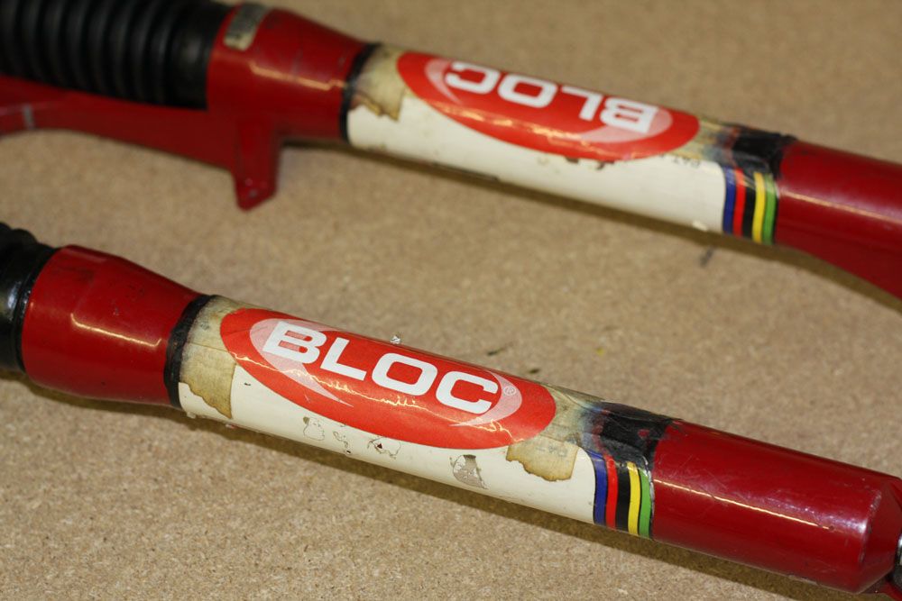

So, as they came after winning the auction. Dirty seals, and a lot of chunks out of the decals. Also some masking tape and other stickers on the rear which look like they were added to stop the original decals coming off.

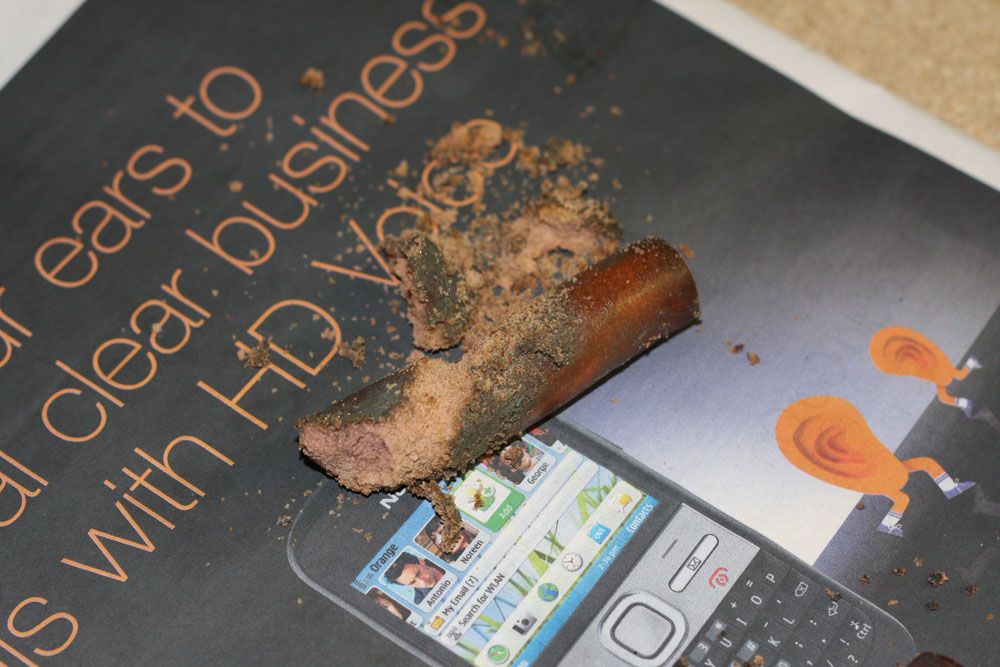

They seemed to only have about 10 - 20mm of travel at best. It seems this was solely from the top springs as the elastomers were totally shot.

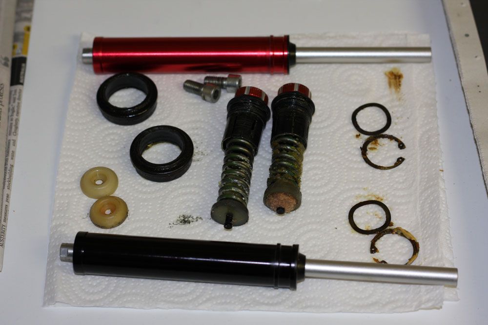

Most of the inner parts stripped and to be cleaned up.

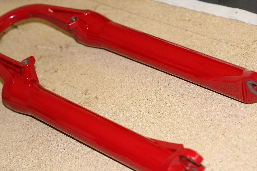

So I set about removing all of the old decals / stickers to see how bad the paint was, which to my surprise actually looked very good indeed. Seems the decals were actually the only parts with the knocks and chunks missing.

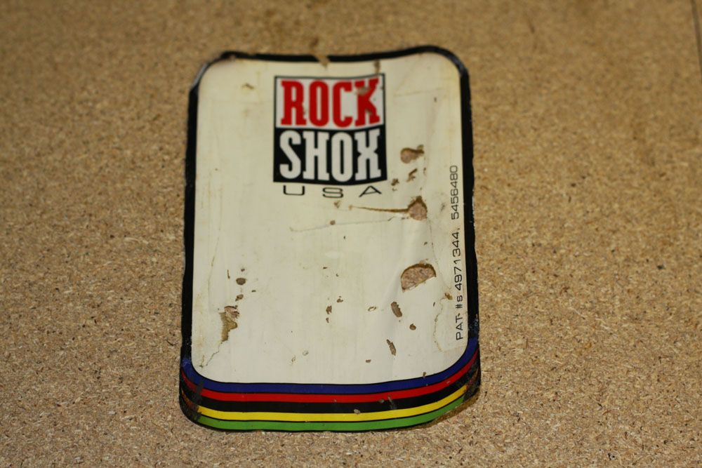

I managed to save one of the decals whole. This was then placed inside a clear food bag and scanned for tracing on the PC as a basis for the new decals.

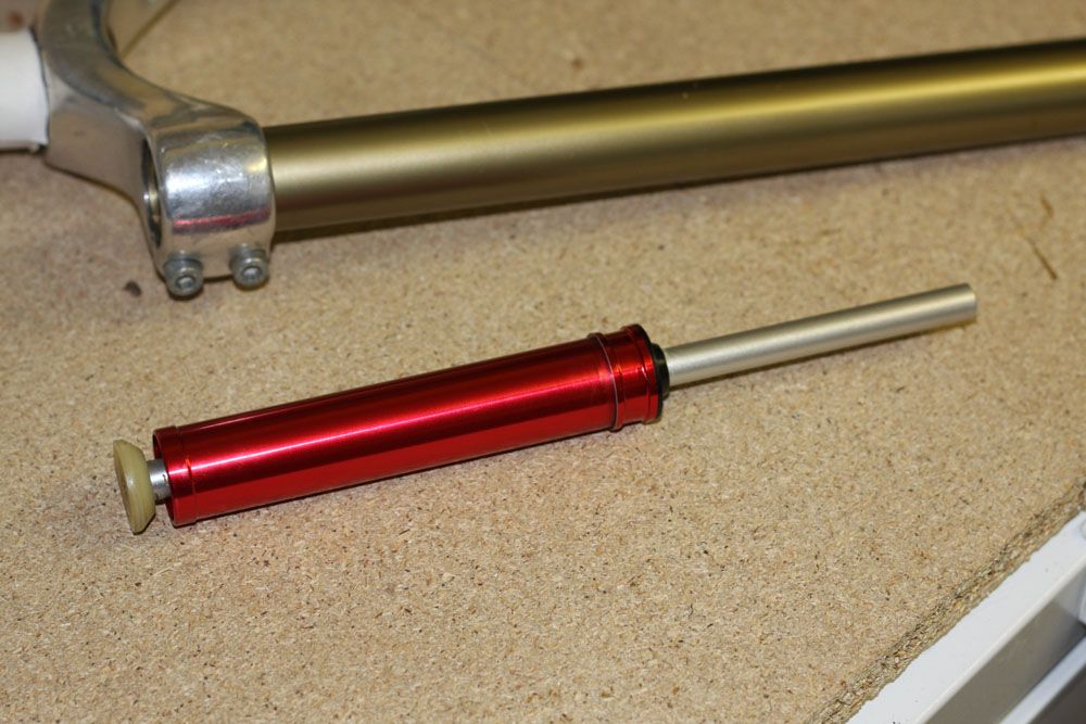

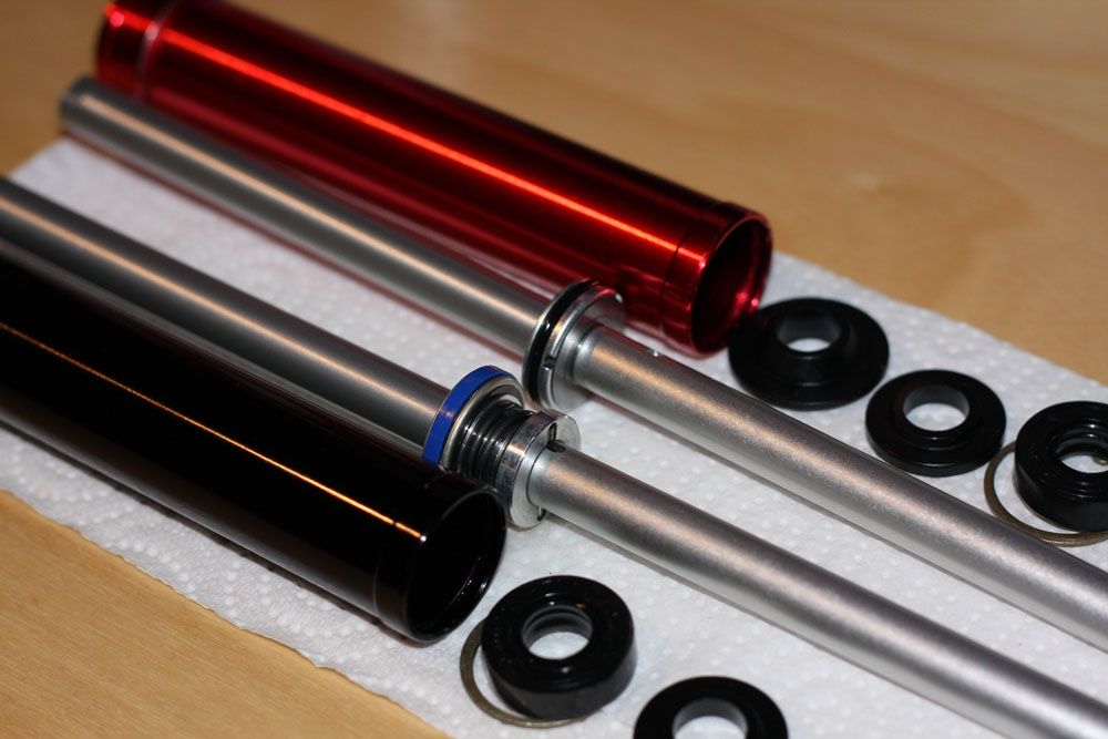

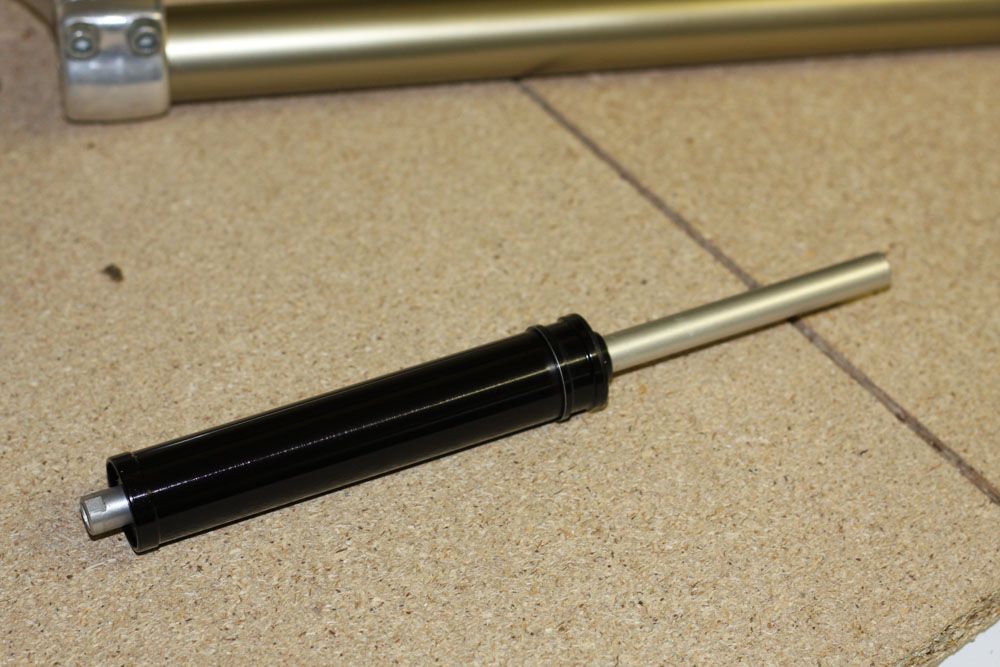

Stripped down the damping cartridges and cleaned then up. Was hardly any oil left inside them also so were definitely in need of a service.
From here it was a case of refilling and assembling the damping cartridges. Then fitting the new top seals, the newer samurai seals so they can run without the dust boots, and basically grease up and fully reassemble. We've changed the spring / elastomer stack for a set of medium weight springs which should suit my brother perfectly.

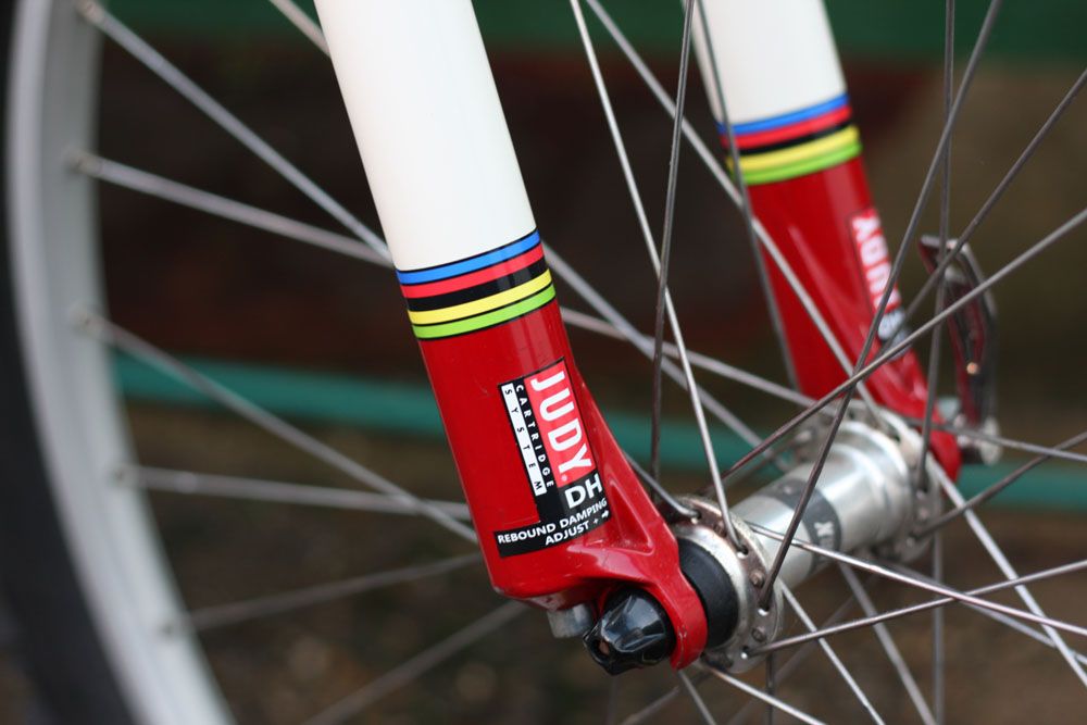

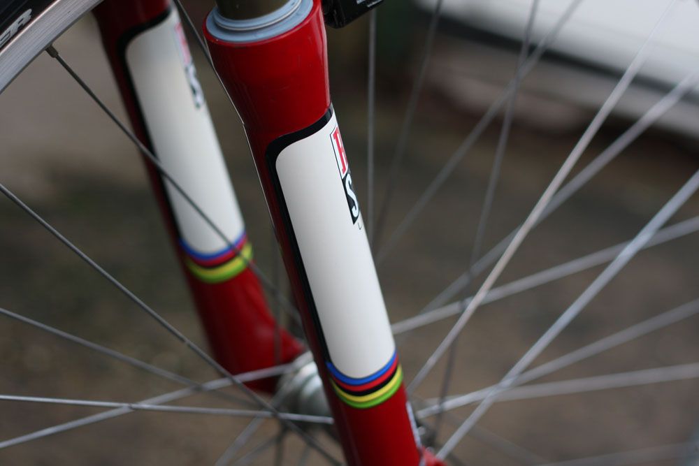

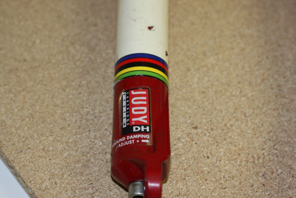

The new decals were completed on the PC and printed out on glossy white vinyl, cut out and applied to the forks. Not done any decals before myself so not sure how long this method of print will last.

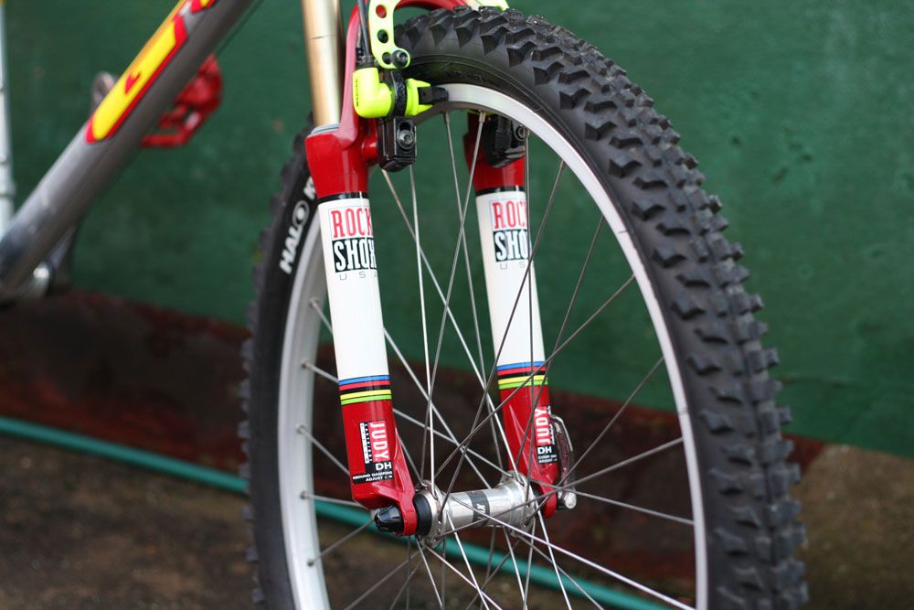

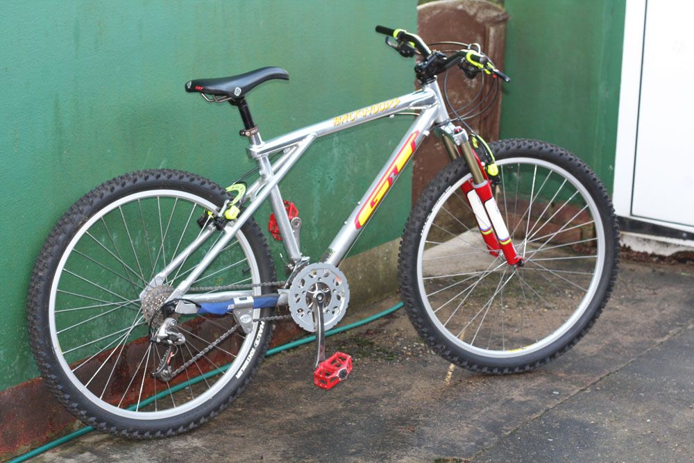

So the finished product back on the bike...
Really pleased with the result both the look and how the forks now work. Just need to get the rest of his bike done now so we can get out on them again :)

Added the links for the seals now.
The springs were actually out of my XC's as I needed firmer weight ones which I finally found and modified to fit. So the springs were already ready to fit.
The decals as I said were printed at home on a standard Canon photo printer using this 'paper':
http://www.amazon.co.uk/Inkjet-Creative ... 153&sr=8-1
I just cut them out by hand and they look very good. I had to use a black marker to run around the cut edge so the edges didn't look like they had a white border just to finish them off.
I'm not sure how long they will last tho, I read somewhere that the ink in home printers is no UV stable and so the colours will fade quite quickly in the sun. But I tried one under water and it seemed fine. So even if I need to print off a new set every season it's no problem.

Thanks! As I said tho it's my brothers bike I just decided to have a tinker with it after finishing sorting mine out. This backwoods I think is a 14.5" frame so it's a bit too small for me. Also needs a lot more work yet, certainly needs a full polish as the ball burnish (if it actually is that finish?) has gone dull but I tested with some autosol on part of the top tube and it came up lovely :)
Also the Maugras were never set up right in the first place so they need sorting out, and the gear cable outer for the rear mech is all split and needs replacing.
Other than that it just needs a good clean and regrease before it's all done. We've already put a new handle bar and stem on it. The steerer on the new DH fork was too short so by leaving off the top headset spacer and going for a slimmer fit stem the top tube is now only 2mm below the headset top cap which I thought would be fine.
I'll post up some pictures of the finished bike when it's all completed tho anyway. Along with some final shots of my Zaskar too :)
