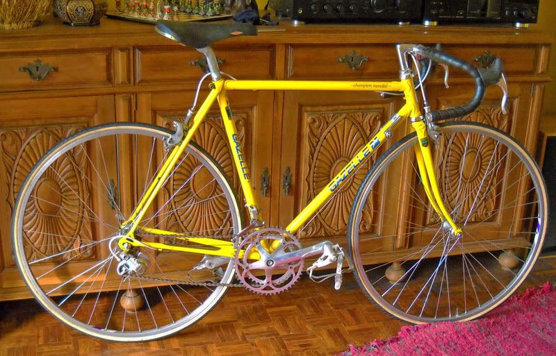

 I've been after one of these for some time. Last November I finnaly found one. Altough not my favorite color it's exactly my size and got it for a price that I could aford. Here "she" is the day "she" got home.
It's going to take lots of work to get "her" back rolling and I'm going to enjoy every minute of it. 8)

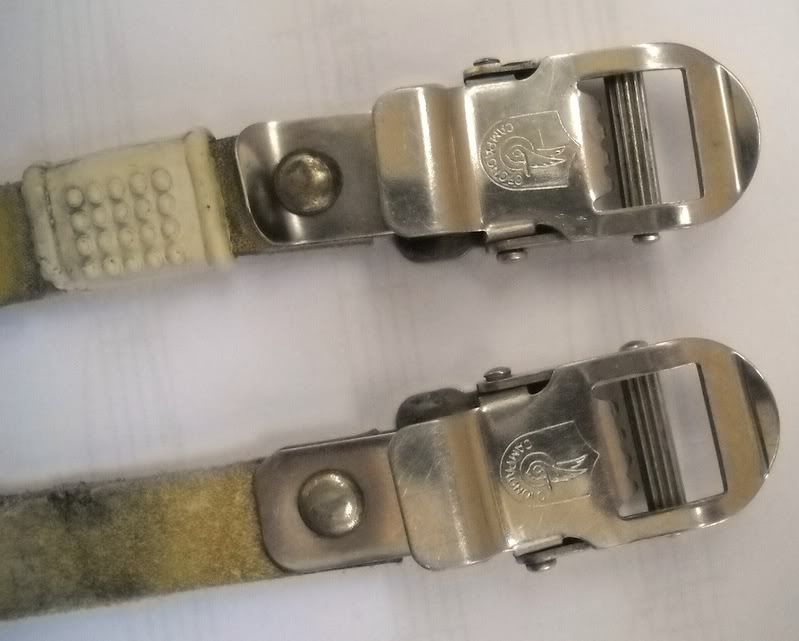

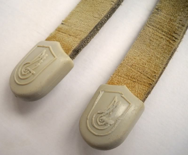

As time is short these days I started with an easy bit or so I thought. Here are the pedals.
The right pedal is missing the original clip fixing plate and bolts. The axle plastic cups have seen better days too.
At least they come with the original leather straps. Dirty and dry!

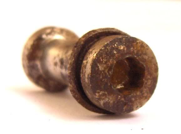

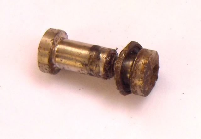

While the straps were in a "bath" I tried to clean the seatpin bolt.
After some work most of the rust was gone but with that crushed, bent washer plus the loose allen key hole I decided to use a new one. Had this already in my parts box. 8)

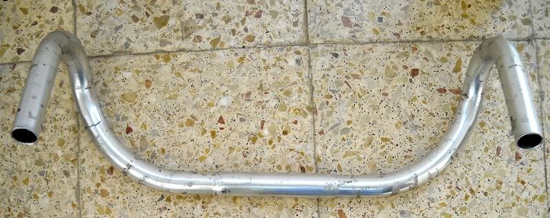

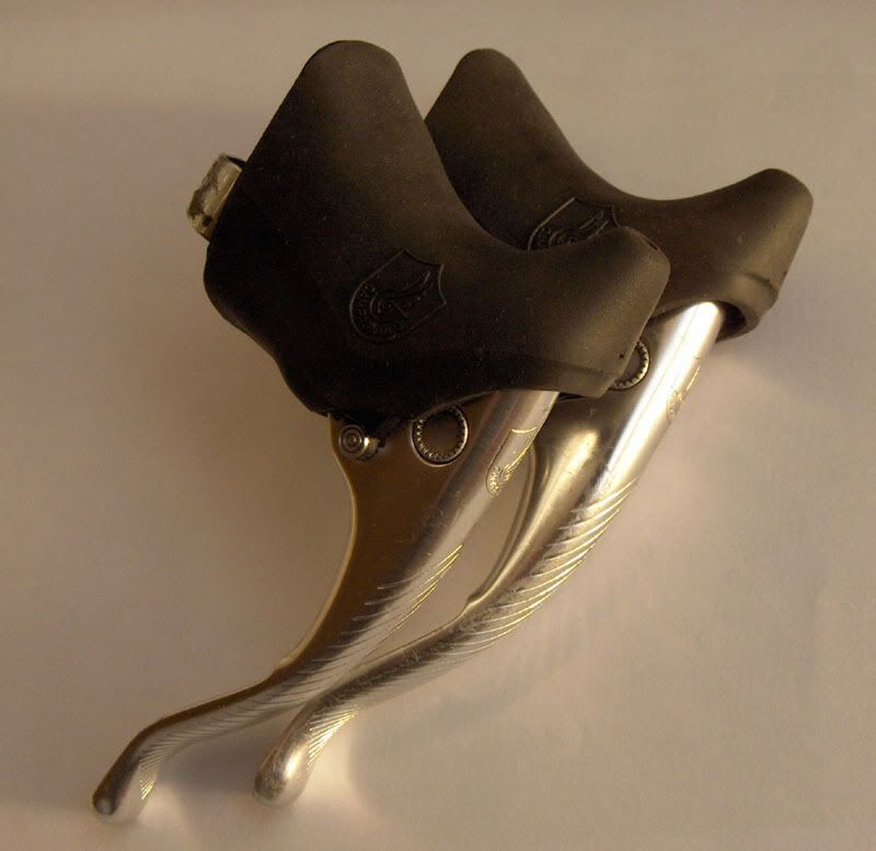

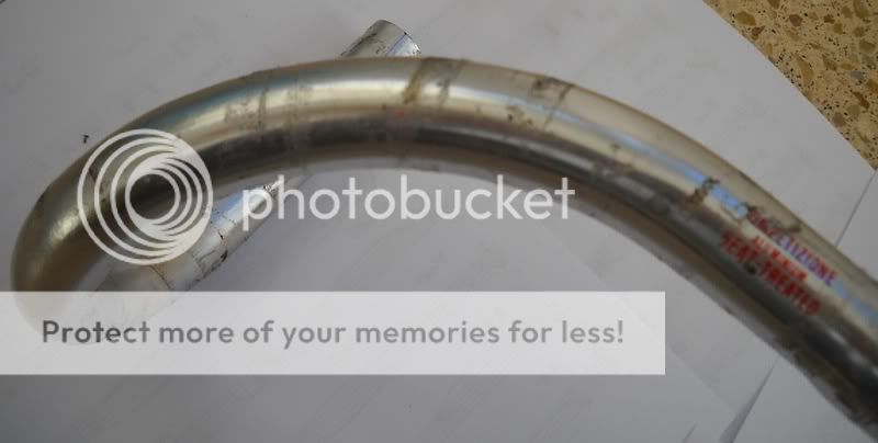

Unfortunately the handlebars that came with it are just too wide for me so I removed the handlebar tape, brake levers and cables.
The bars still need to be cleaned.
The levers seem in a good state. Only need to clean the hoods.

It looks a nice example to me, so great she found a good home. Nice Athena groupset on an AB-frame. It does day AB-frame on the chainstay?

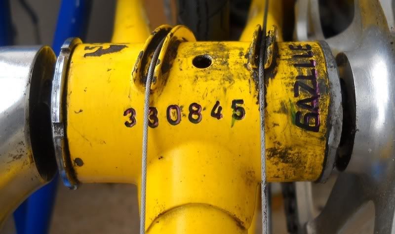

I can't see how the rear brake cable is routed in the 1st pic. You have a close up pic of it? What does the serial say?
PostPosted: Mon Dec 06, 2010 11:02 pm
Joined: Fri Sep 17, 2010 5:34 pm
Posts: 532
Location: Olissipo-PT
Yes, it does say AB frame in the chainstay.
Here's that serial:

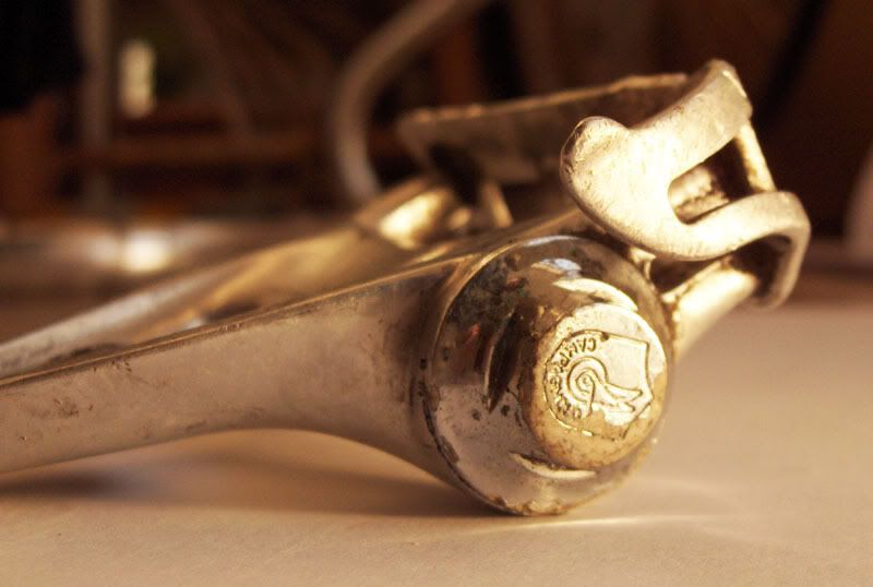

Another setback. :( The left shifter is missing a part. I suspected it when I saw the wing nut sunk into the lever. Got exploded view from a campagnolo catalogue and it's confirmed. I'm missing the conical nylon washer. No 12 in that view.
With out this washer the shifter won't hold its position so the chain keeps falling to the small chain ring.
I remember I had this older campagnolo shifters in my parts box.
I took them apart and found a similiar conical nylon washer.
Took it to the Athena shifter and it fits perfectly. :D Now I can ride the Gazelle while I search for that little washer. If any of you have a spare one please let me know! 8)

In the mean time the straps came out of the bath. They're dried and straight now. Cleaned and assembled the plastic caps as well.
Still need to flatten that little metal tab and apply some bees wax to the leather.
Did the old rusty bolt have had a "locating tooth" ? I see the new Campag one has visible "knurling" to lock it in place.
