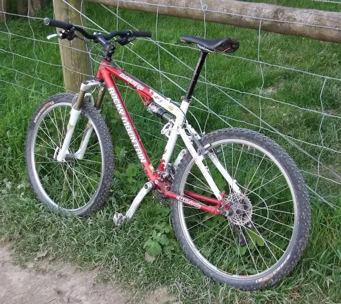

Not a very good picture I'm afraid, but this is also a 2002 Element, a Team scandium which I think weighs 11.5kg. It has a 2002 Marathon S, which I think was the original spec for the bike, although I found it much later. Quite rare forks, superior to SIDs in my opinion, about 150-200g heavier, but stiffer and plusher. I'm thinking of converting it to discs for 2014 so I can fit ZTR Crest wheels, but I'm not sure it would make all that much difference, as I don't use it in the winter.

Mine was a 21.5" frame and it weighed bugger all, really surprised me.
