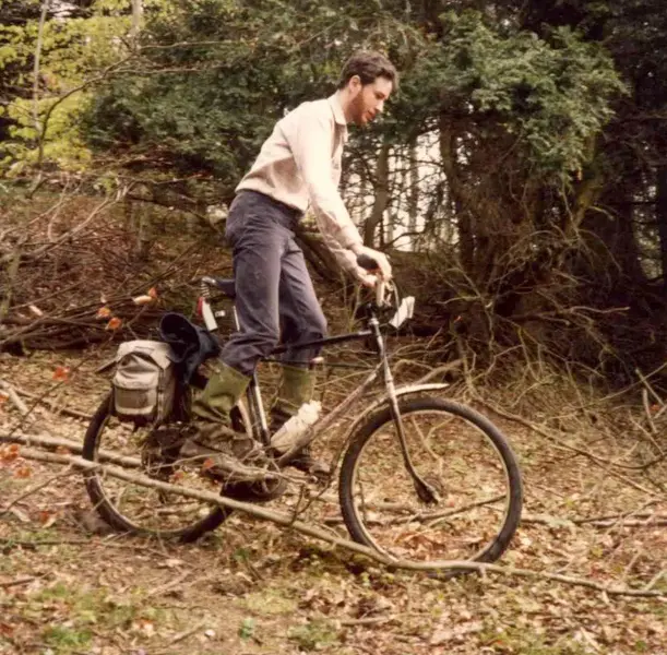

File comment: This riding technique is classic Cleland. Rolling along whilst standing upright and letting the bike rotate, seesaw style, underneath you. From this position you can also hop either the front or rear wheel over any obstacles or in this case branches.

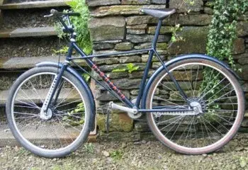

This is a 700c wheeled Highpath' Big Blue.
This design can be made to order by David Wrath-Sharman at Highpath Engineering. This is at present is the only modern Cleland that uses a custom made frame.
David also has the parts to make the original 650b Highpaths apart from the 650b x2" (54-584) Nokia Hakkapeliitta tyres which have not been made since 1993.
The only other suitable low pressure tyre is the 650b x 2" (54-584) Nokian Hakkapeliitta STUD A10s. Nokian however. tell me that this size is no longer available despite still being shown on the Nokian website.
http://www.suomityres.fi/hkplstud.html
If anyone knows of a supply of these (54-584) tyres, please let me know.
In the mean time the search is on for some modern 650b tyres that can handle pressures as low as 15lbs PSI. The best bet may be to pair up some 650b tubeless tyres with some heavy duty downhill inner tubes.

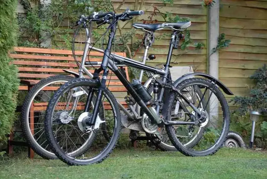

The Cleland frame geometry is similar to the geometries found on many modern bikes. So two styles of modern Cleland have been developed and built around modern stock frame-sets.
The top picture is a geometry shot of a 1988 Highpath Cleland hiding behind and Small framed 2005 Giant NRS3.
The middle picture is a geometry shot of a 1988 Highpath Cleland and a modern Cleland NRS prototype.
The bottom diagram shows the geometry of the 1988 Highpath Cleland shown in the pictures.

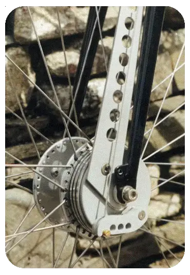

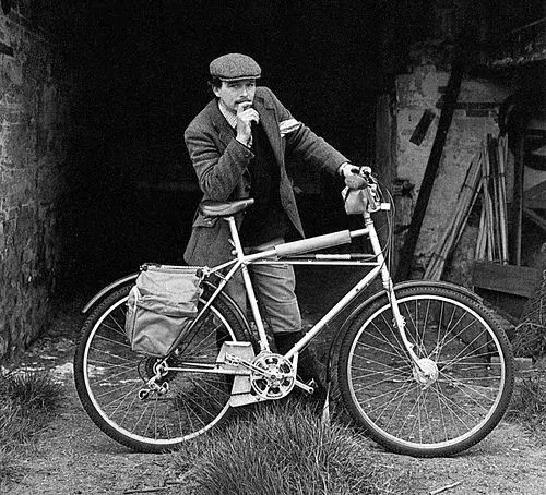

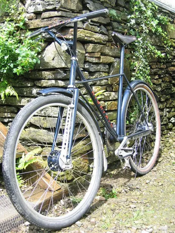

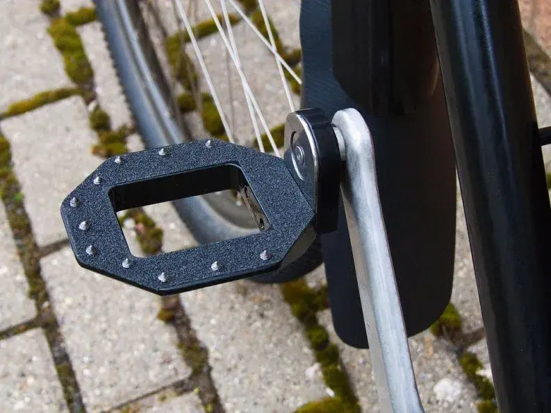

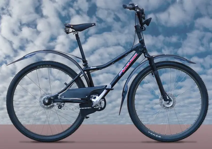

Geoff Apps was in all probability designed and made the first 700c wheeled off-road 29er bicycle in 1981.
The top picture, taken in 1983, is Geoff and his 1981, 29er Cleland Aventura prototype.
The second picture is Geoff and his latest Cleland Aventura TT (2010)
Subsequent pictures show the TT and its features in more detail.
Geoff describes the TT as the bike he wanted to build 30 years ago, but could not find the high quality components that are available today.
File comment: Geoff Apps 1983
File comment: Geoff Apps 2010
File comment: Cleland Aventura TT
File comment: Geoff's swing pedal design

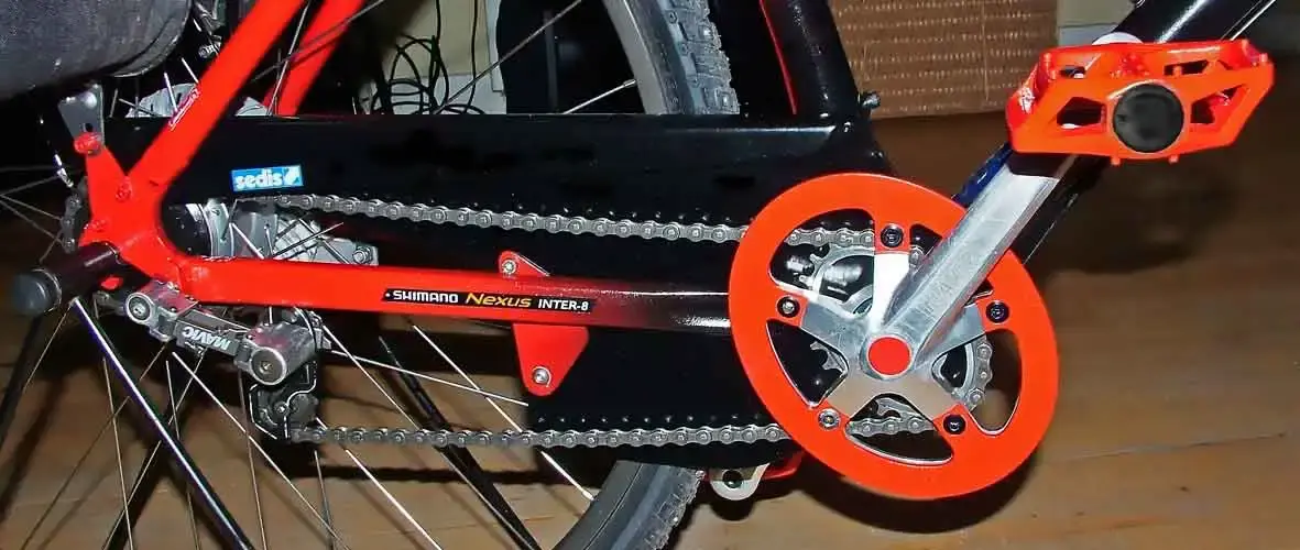

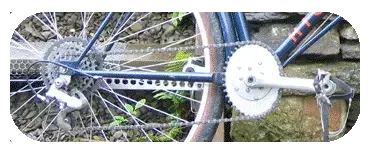

Mavic ATB Cranks? the moment. The close up of the same crankset on a 2006 bike might help you to identify the make. The important factor is to have a small PCD in order to accommodate the minor axis of the elliptical granny wheel. For the Clelands NRS.
I use 58mm PCD chainsets sold under the Thorn brand.
Tubeless tyres and inner tubes?
The problem is that tubeless tyres are fine at 30lbs PSI but at 15lbs PSI they become unstable when cornering. The Idea of using heavy duty inner-tubes as well as tubeless tyres, is based on the fact that the original Cleland Hakka tyres used large, heavy duty tubes that weigh 8 oz each. Some heavy duty Kenda tubes have just arrived in the post, so I will soon know if this works. It is important to use tubeless rims as they don't let the tyres slip until the valves rip out.
But why carry around the extra weight of a heavy duty inner-tube?
On smooth surfaces it only makes sense in terms of increasing tyre contact patch and so the grip. On rough surfaces, like cobble stones, the low pressure tyres can absorb all the vibration and so reduce the rolling resistance. Tyre design is important in that an inflexible tyre will have a very high rolling resistance when run at low pressure. The original Cleland tyres are thick but flexible, and are remarkably quick off-road.
