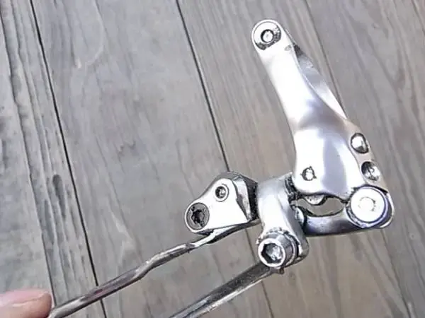

Whilst I was adjusting the RD tension, I noticed that my FD also has a similar flat-headed spring tension screw (NOT the Hi Lo Philips screws). My model is FD-M651. The screw head nestles flush to the FD body, and (unlike the RD version) has both an Allen key hole and a slot.
The screw head has a tiny arrow, and when this points upwards it is at the Minimum spring tension (you can feel it is far less). It seems to have only 2 default position 180 degrees apart, and I can definitely feel the difference between the Maximum and Minimum at the thumb lever, again, unlike the RD version.

I know what it is you are talking about, bottom left of the sheet (from other thread)
http://www.retrobike.co.uk/gallery2/mai ... ewsIndex=3
similar to in this M901 picture (pinched off web)
File comment: tension adjuster front mech

Yes that picture shows the FD screw clearly, so people will know what we are discussing.
It's the blackish-gray screw with the Allen key and slot.
You can also make out the alignment marks too.
On my model FD-M651 when the marks are aligned together, that is the least tension.
Converesly, and perversely, for the REAR deraileur, that alignment is the Maximum tension.

But that mech is near on identical to the M651 mech (Deore DX top pull) . I have both sat next to each other ;) Just the materials are a little different.
Hence why to use the FD-M901 documents.
It would probably be the same picture as they where just relabled documents and this has the alteration of the XTR shifter, hence why they would make one for it.
(The picture above is XTR)
