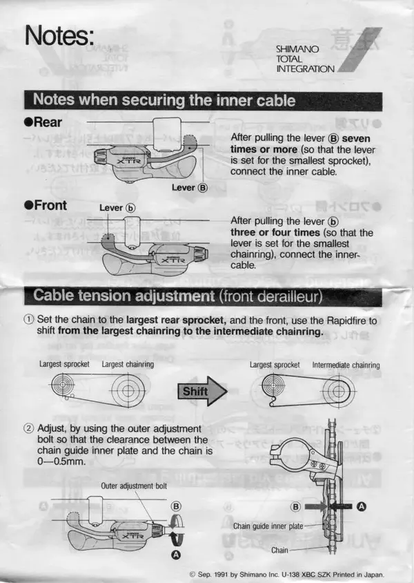

If anyone has the front and rear derralieur setup sheets for m400 (exage 400lx) and setup sheets for br-M201 cantis i'd be really greatful!
I also have a bunch I have scanned, but the board won't let me post them Is there a place they can be uploaded? (largest is 852kb)
Thought i could add them here, but this has gone haywire?
http://www.retrobike.co.uk/gallery2/mai ... emId=74310
Rich

Instructions for U-brake, DeoreII, M900 down to Altus/200GS, RapidFire and front and rear mech setups have been added .
9 up so far
I'll alter titles to make them easier and add tags as I get time
http://www.retrobike.co.uk/gallery2/mai ... emId=73339

misterfixit,
just to say I put up the second lot a few days ago and it's already been of help :)
http://www.retrobike.co.uk/forum/viewtopic.php?t=104492

Thanks to Misterfixit for scanning these, it's a great helpt to have the original maker's service instructions for these old bikes and parts.
As FluffyChicken noted, your scans helped me to discover how to adjust a very obscure parallelogram tension screw. One look at the data sheet picture of it, and I understood.
Any chance you could post the Service Sheet for the FD651 that's on my 1992 Panasonic? That's front deraileur.
Use the FD-M901/M900 one and it's notes. They are the same design mech pretty much.
