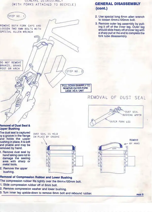

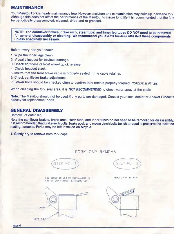

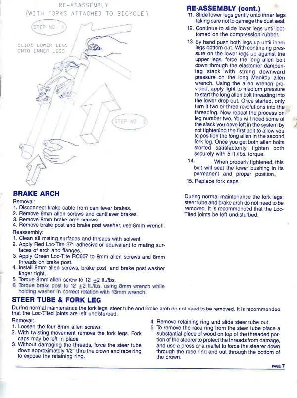

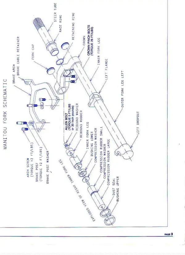

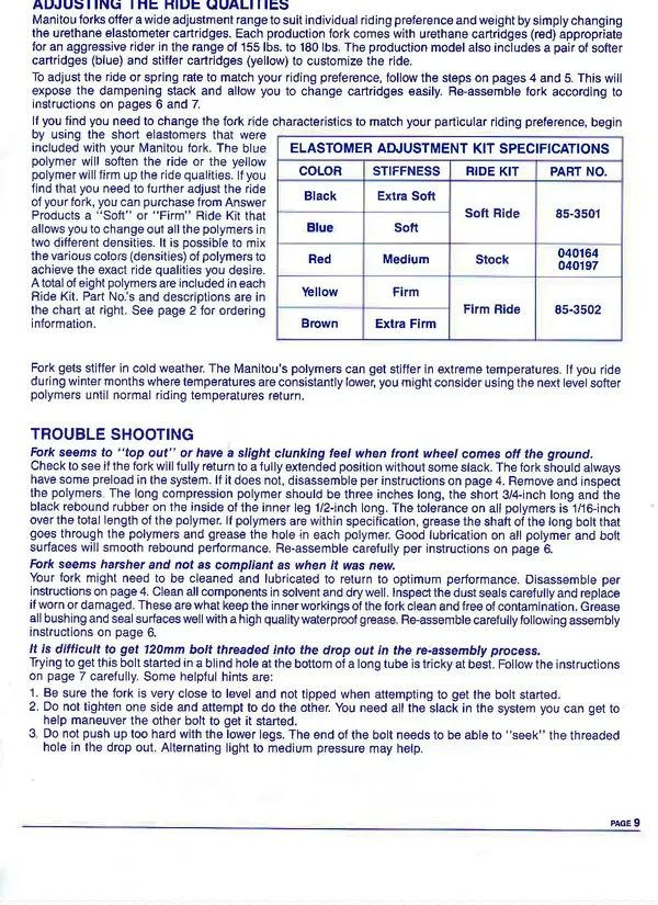

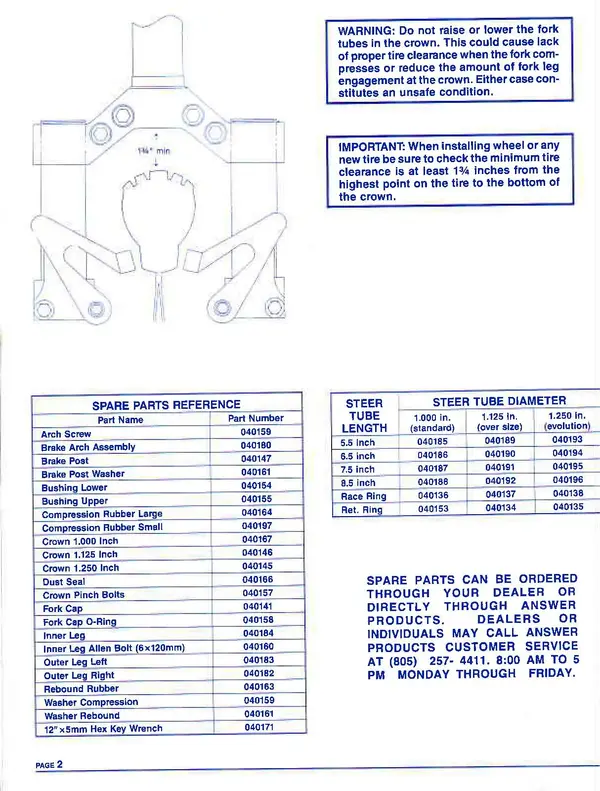

Hi to all
Here's the full copy of every page of the owners manual - with the original dis-assembly / re-assembly instructions etc
Took me a while and fair bit of effort to source this - so enjoy!
