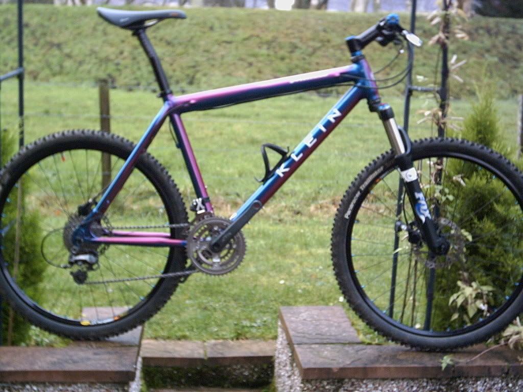

heres a few pics of mine :D
I've worked out that I've just been a bit of a wuss in not wanting to scratch the paint. With a generous helping of Maguires Wax I've managed to pinch the band on.
Your pictures prove that the Trek Klein's can still be brilliant looking bikes. Did you like the ride of your one?

Ye :cool:
the klein was weapon light :D man i had it built with carbon rc31s & xtr. must have weighed in about 20lb. lightning fast on the climbs :shock: XC weapon!
Great bikes although the klein purists knock them :LOL:
that zr9000 frame tubes are well under rated id say, big up the treklein :cool:
post your up when its done.. ill look forward to seein that one :D
