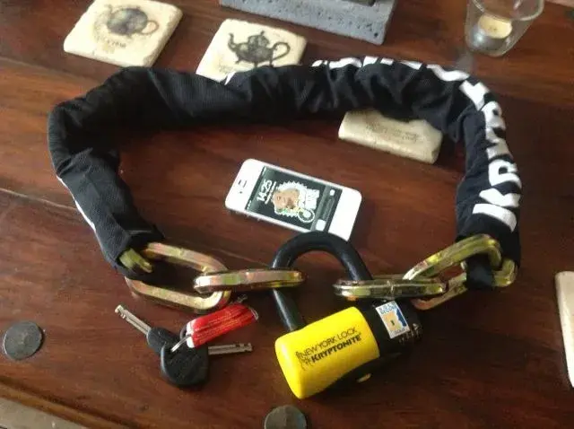

I just got a Kryptonite after a spate of bike thefts locally, seems pretty good ( though you will never know until someone tries to steal your bike if its any good) like most things will never stop the thief, just slow them down :evil:
see phone for scale
