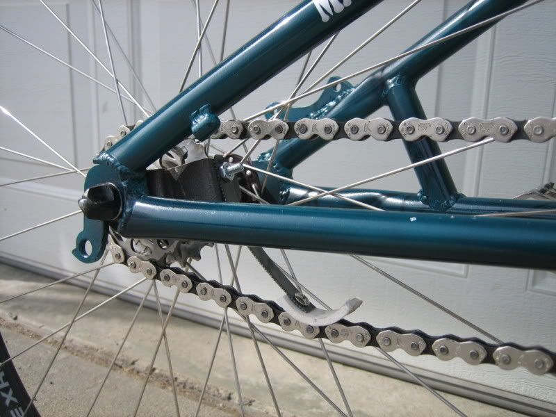

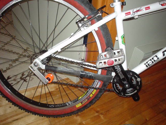

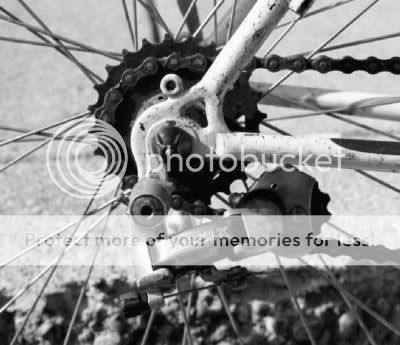

its too late in the evening for me to post pics but i have some where the lower jockey wheel has been removed from a mech so its just the upper and i even have a pic of a canti used
theres the option of using a lower chain device which i think is neater , certainly would make taking the wheel out less hassle
i think i even have a pic of a urethane block used to create tension

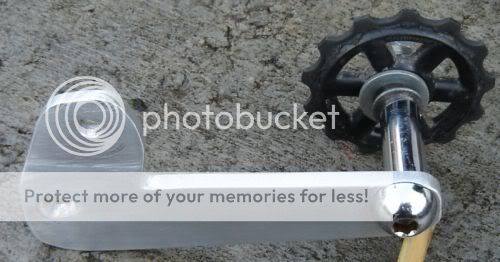

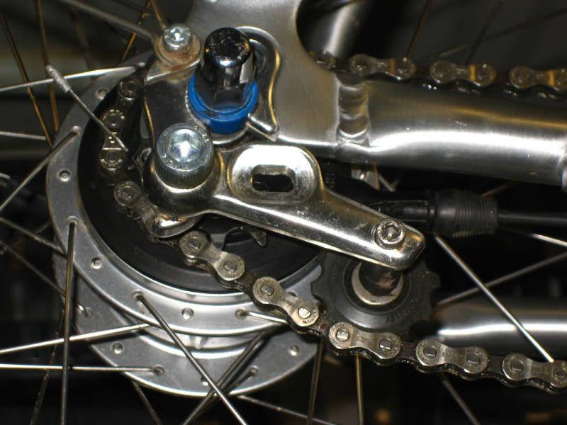

the canti brake tensioner is a stroke of genius.
I'm stroking mine right now....
Listen...
You can hear it purring...
PostPosted: Mon Apr 27, 2009 10:23 am
retrobike rider
retrobike rider
Joined: Tue Nov 11, 2008 12:28 pm
Posts: 4179
Location: rutland
yeah the canti is my favorite , youd never consider it just looking at one
PostPosted: Mon Apr 27, 2009 12:33 pm
Joined: Thu Apr 10, 2008 4:16 pm
Posts: 9609
Location: brigg, home of the gypsies
the canti arm is a really neat solution.
