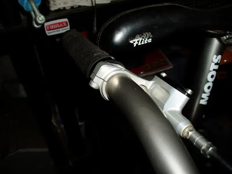

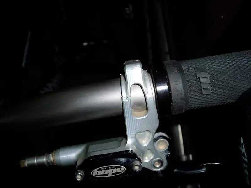

Been in the garage giving the Yeti a darn good clean after the excellent ride in the HoNC when I noticed this on the Moots ss. I've seen pictures of this once before, some guy on STW (I think) posted a pic but I put it down to him over tightening the clamp bolts... perhaps not eh? Anyway, I use Moots ti risers and previously used Easton Carbon Monkeylites so have never dared over tighten the bolts and yet here we have the crack. :cry: I think I've had these brakes for about a year.
I've just sent pics to Hopetech, let's see what they have to say.

it was someone else on here as i remember it . it was during the winter and it was thought to be a result of the freezing wind rushing over it
certainly a design flaw

The guys at Hope are cool, I reckon you'll be fine with getting it sorted out. Let us know.

Hope replaced my master cylinder under warranty.. No quibbles. Leisure lakes sorted it all for me. :wink:

the old fashioned steel band worked perfectly and could bent to create a more collar like clamp ,whereas these sculpted alloy castings cannot bend and just crack if the bolt is overtightened
And i imagine the weight difference is only a couple of grams

The guys at Hope came good 8) . Posted the lever / master cylinder assembly on Tuesday, new lever assembly arrived today and is now installed, bled and ready to go!
Thanks Hopetech. :D
