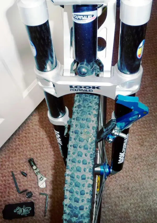

Just tried to fit my set of Crystal Design Vs to my Fournales fork and the lower crown was in the way! :evil:
All I need is to space out the brakes by 2mm and they'll work fine. Anyone got any ideas on how to do this?
I did try putting a 2mm washer behind the brake but when I tightened the pivot bolt the brake seized up. Is there any way to space out the bosses themselves?

lets have some pics
are the bosses removable at all ?
theres normally a large thread on the ones that do , might be able to put a spacer there

Yes, the bosses can be unscrewed. I don't know if there's going to be enough thread on them to fit a 2mm spacer behind them.
I'll get some pics up tomorrow (or later today now I've looked at the time :lol: ).

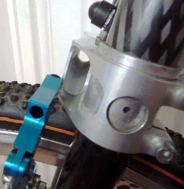

Well here's the pics. I think I've sorted it now. I'll have to wait until morning to find out though. Basically put 2mm of washers behind the brake boss. It should be OK as there's 10mm of thread and I'll be using some locktite.

dont forget to account for slop in the canti regarding clearance
looks cool and i spy a cool tool too

I hade the same problem, but it was just the bracket bit that the noodle fitted into that was making contact- I just bent it enough so it would clear!! :P
That's not an option for the brakes ye've got, so here's hoping the spacers work.

Unusually for Vs these don't seem to have any detectable slop on them.
