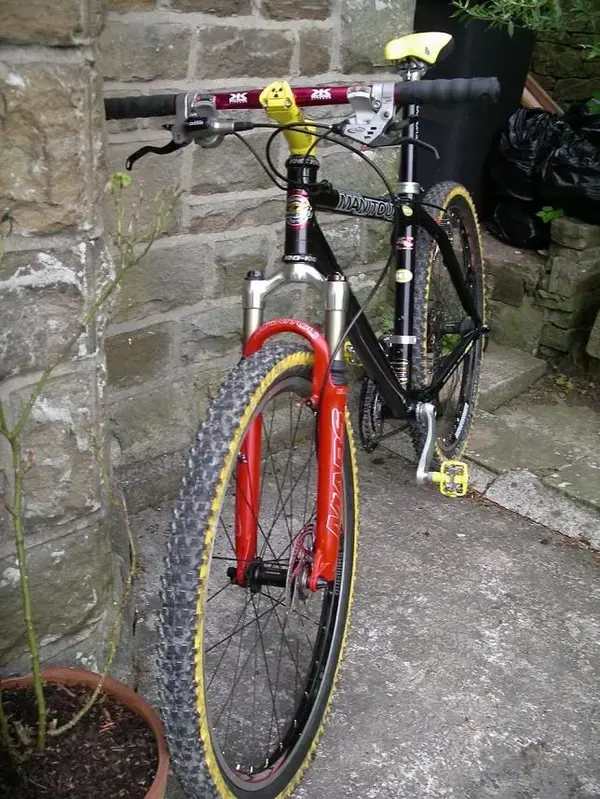

There's not much wrong with the stopping power of a 185mm Avid BB7 / XTR V set up in my opinion.
Alternatively, the old style Shimano hydraulic levers match up quite well with Avid V levers
