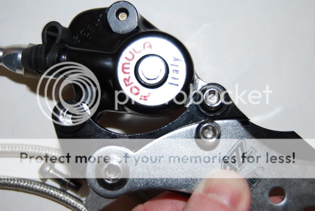

I have a set of formula brakes as shown, The rear is non standard with the ( as new) wheel I have too :roll: as I have been told early Italian bikes had different standards

hold tight with my tech talk here!! :lol:
If you bolt one end of the caliper on , the other end is short by about half the hole ? :? a guess 0.5 cm
Hub wise , I could spin a hope disc rotor with it on?
If you want some photos I could take some pics with it dummied on a A2Z adaptor for you to see?

Pics would be nice please Daj. I haven't actually bought a disc or a hub yet so I'll wait until I can age it to find out what parts I need. I've got 96 bombers on the bike the brake is destined for at the moment so i might be in luck!

Here is some pics
The rear
