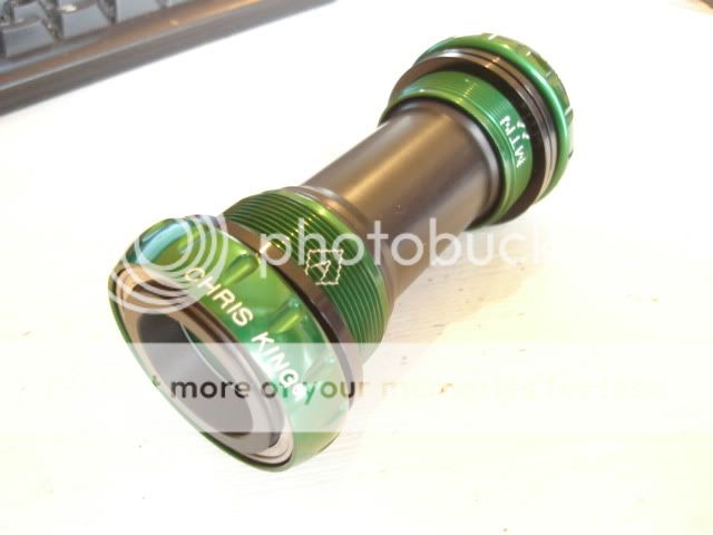

I picked up a King BB a few months back. still totally smooth despite high mileage & no cleaning. I'll let you know how I get on..

By the way Scant, have you re-greased the King BB at all in that time, or has it just stayed naturally smooth?
EDIT: just seen the " ... no cleaning ...", must improve rudimentary reading skills :roll:

I never thought I'd say it, but that King is a very sexy looking bottom bracket (I'll add my own fnar, fnar)
