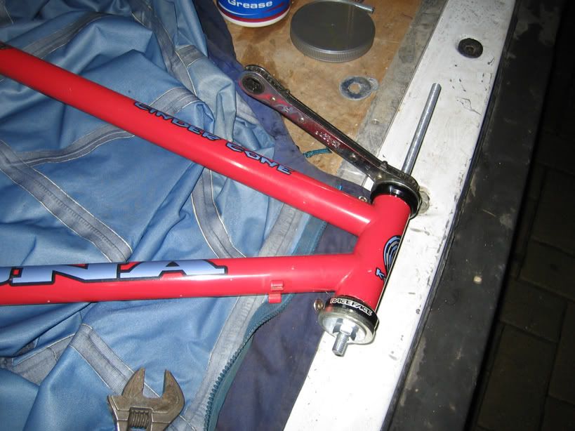

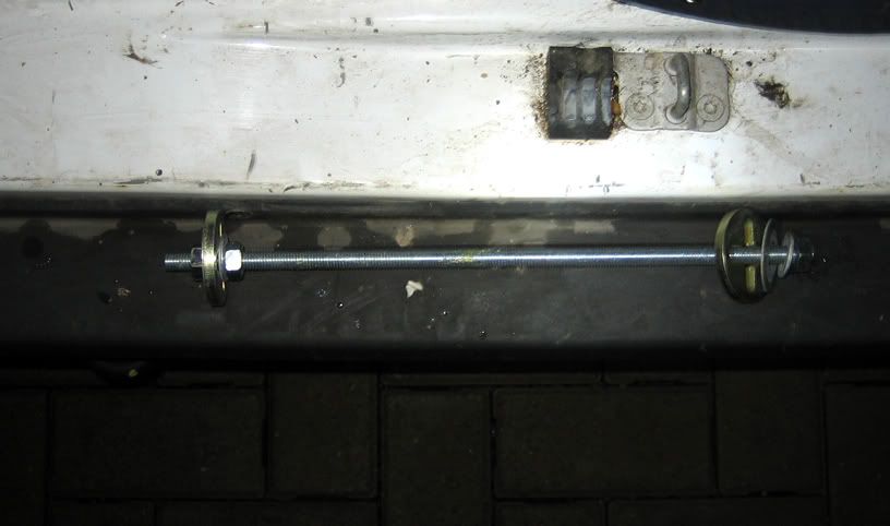

I was bored at work so i made this, tried it out when i got home and it works perfectly! Much better than the previous wooden block/hammer approach :D
Consists of:
Bit of 10mm threaded rod
3x10mm nuts
2x big round 10mm washers
2x smaller washers
Good times :D

I used a similar setup of 10mm threaded bar with some gert big washed for years worked perfectly
Recently purchased myself a proper headset press and it is an improvement, but only in so much as it's quicker to use and the built in handles are longer and more comfy that the spanner I used to use. Worth the money?? probably not given how often I use it, but there's something about using DIY tools on nice retrobikes that doesn't quite feel right.
the Murftool looks a damn sight better than my efforts though :D

yeah, Ive made one like this too and it works. Looking at yours tho, I'm not sure about the metal washers being in direct contact with the headset cups. Might it not spoil the finish on the cups, and worse might there not be the possibility of the edges of the cups slightly deforming with pressure.
Mine have big blocks of wood between washers and cups, but if it all works ok, then who am I to suggest different.
PostPosted: Thu Jan 15, 2009 10:10 am
Devout Dirtbag
Joined: Sun Dec 07, 2008 12:38 am
Posts: 136
Location: Inverness
It didnt really take that much pressure to press them in, the headtube was well greased and i gave it a good clean before hand.
If it wasnt going in easily i was going to cut up an old innertube to place between the cups and the washer. As it was though, there wasnt a scratch on the cups and theres deffo no deformation. The washers are big enough to contact the outside of the cups but not touch the bearing race.
The ratchet spanner also made it a very quick and easy job, i used to be scared of replacing headsets to the point where they would all be rough as hell before i replaced them, not any more :D
You greased the headtube before you fitted the cups?
PostPosted: Thu Jan 15, 2009 12:54 pm
Joined: Tue Aug 05, 2008 1:10 pm
Posts: 1743
Location: Peoples Republic of Scunny
And you pressed both cups in at the same time?
PostPosted: Thu Jan 15, 2009 5:46 pm
Devout Dirtbag
Posts: 136
Location: Inverness
Yep to both. A smear of grease to stop the cups seizing in place and make them go in easier. Both cups at once cos i dont know any better :lol:
Is this wrong? Its in perfectly straight and doesnt move, ive always done it this way. Educate me if i've made a F*%^ up :oops:
