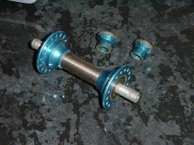

does it look like this one?
PostPosted: Thu Jan 15, 2009 11:42 am
Joined: Thu Jan 25, 2007 9:37 am
Posts: 4916
Bingo! :) Is that an ultralight or something different?
Are you able to move the axle from side to side in that one too?
So at least it appears correct that the ends just slide off! :lol:
When mine is all bolted up there is no play and it spins forever, but the design is slightly disconcerting.

I can confirm going by the dents in the top of my PC storage drawers, the axle does not move.
PostPosted: Thu Jan 15, 2009 11:46 am
Posts: 4916
Hmmm, me thinks i'll be investigating this wheel a bit further before i ride it! :lol:
