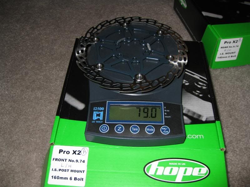

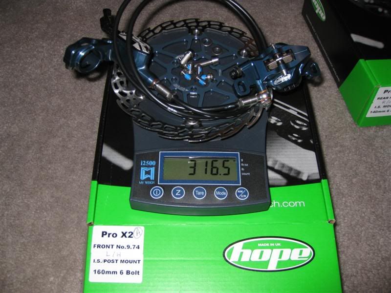

So received these from http://www.wiggle.co.uk/
They were back ordered, but still shipped very promptly and qualified for free shipping. Sweet!
Here are the pics:

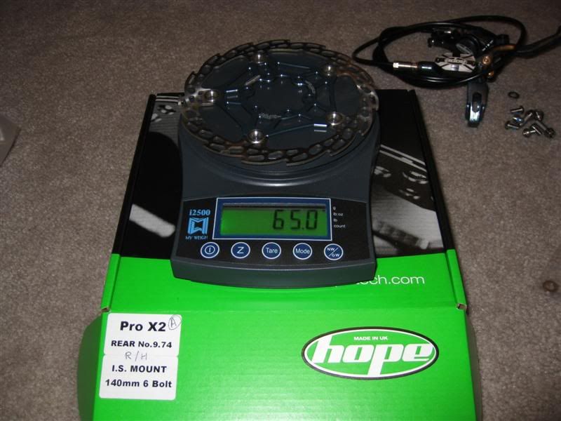

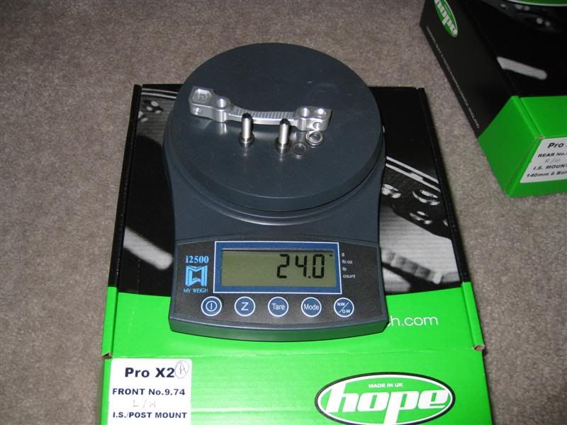

160mm Left hand lever, all bolts, all washers, no mounting bracket (most people use post mount these days)
Post Mount to IS adapter:
160mm Hope Floating Pro rotor (1.8mm thick I believe, so not the standard floating rotor)
140mm Right hand lever, all bolts, all washers

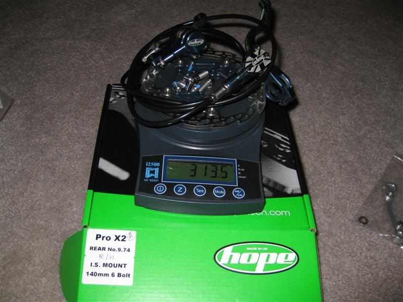

Post mount for rear brakes to frame (I haven't see a post mount rear frame yet) - same weight for the front and rear pic, hence same picture
140mm Hope Floating Pro Rotor
Tuning potential:
-Carbon Master Cylinder Reservoir cap from http://www.fibre-lyte.co.uk/
-Aluminum bolts for the levers (Hope supplies Ti)
-Ti or Aluminum washers (Hope supplies Stainless and really crappy quality ones)

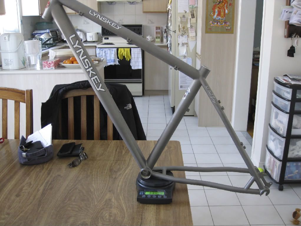

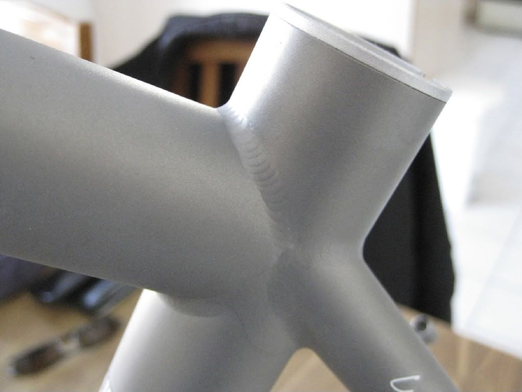

And she is going to be fitted onto this:
2009 Lynskey M230 Semi Custom
-Level 2 tubing
-Top tube underside cable routing
-Shaped downtube
-Size M w/ modification of effective top tube length to 22.5"

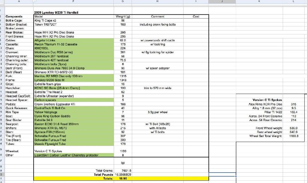

Sub 17 lbs Titanium Hardtail
not very retro... but I tried to keep the idea of boutique CNC'd parts and Titanium strong. I actually thought about stripping a lot of the anodizing off and getting a different seat post for 3dV

:lol: I think you better leave that cost column empty :lol: that frame is a stunner 8)

Yes! One day I did a back of the envelope calculation on cost. I'm at 5000 CDN dollars. :shock:
Nice frame! 8)
Personally I'd have had the cable guides/stops on the side, or the top of the tube, as this makes it more comfortable to carry in the event it becomes necessary. Just my personal preference though.
PostPosted: Wed Jan 14, 2009 12:49 am
Joined: Mon Nov 10, 2008 2:14 am
Posts: 87
Xesh wrote:
Nice frame! 8)
Damn, that is a good point. I didn't even think of that. I went for underside for aesthetics as I saw a Kent Eriksen frame done this way and loved the look.

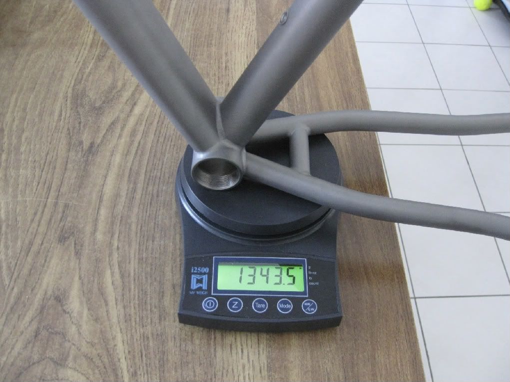

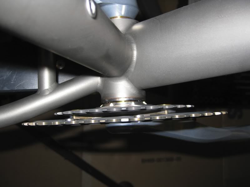

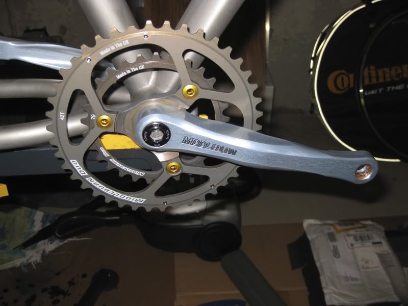

Here is the frame again

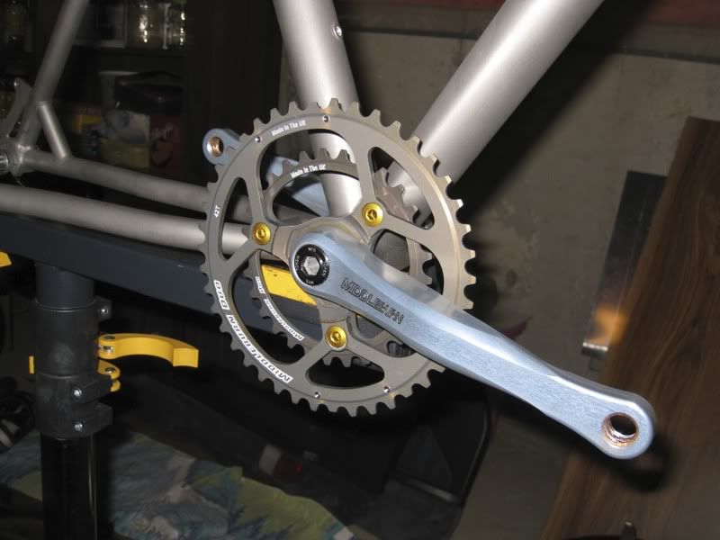

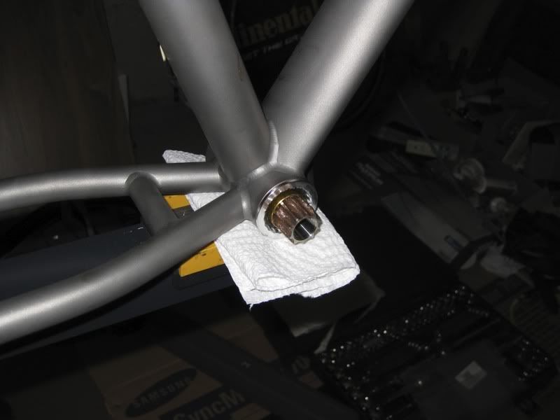

I just received the bottom bracket. So here are some pics. I couldn't resist to go and install it because I was curious if I could get away with a 108mm wide ISIS bottom bracket.
So in support of my UK friends, here are some more UK made parts
I guess made in UK can only go so far. Because this Token Bottom Bracket is made in Taiwan. Lots of anti-seize was applied. You can never have enough antiseize when we are talking about freshly cut Titanium alloy and raw aluminum alloy trying to thread together.
She barely fits!
I hope there is no flex in the frame/bottom bracket/chain rings.
I hope you guys don't mind me posting pics here. You guys seem like a cooler bunch compared to the guys over at the various weightweenie forums I frequent.

Your projected weight is around 2lb less than my Merlin Titanium S/S and you've got gears, front suspension and disc brakes! I wonder what I could get that down to if I built it with a choice of components rather than what I had knocking about ....
