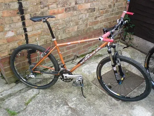

here is a pic of my 94 cindercone with modern parts. probley not to everyone taste but a nice ride on a small budget :wink:

looks good dude. how much travel are in the forks? does it ride ok?

100mm i think, the fork was ok. i only realy noticed the difference after going back to P2s, most of the time they were locked out.
