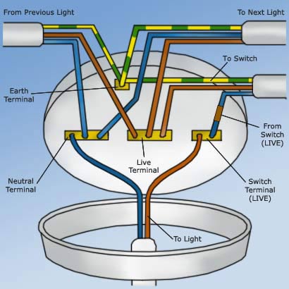

Plus the fittings worked before with that set up... Or close. Been mulling it over and I think what I've done is disconnecte the second fitting from the lighting circuit. I presume one of the additional live feeds is supposed to carry the power to the next light on the circuit.

Each lightfitting is connected in series, the Neutral on the bulb holder is permanently connected to the Neutral on the circuit. The Line (live) is connected to a separate connector and the lightswitch wires (ideally both will be brown or brown sleeved) connect between the Line of the circuit and the Line of the bulb holder.
All earths should be connected together, if the lightfitting has no touchable metal parts then they don't have to connect to the lightfitting, just to each other but it must be secure.
Just remembered you have the old colour wiring. So:
Brown = Red
Blue = Black
And make sure you isolate everything and test, some people share between upstairs and downstairs lightcircuits so test everything before touching.

As the OP says, something is no longer connected, either on the the three red wires (circuit in and out and switch feed) or one of the blacks (circuit in and out).
