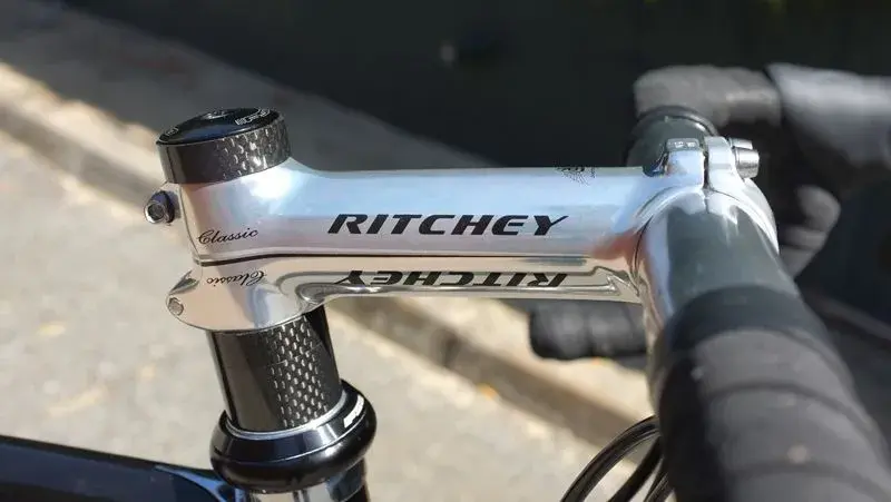

It's a sort of yes and no. They don't score big points on adjustability and it can be fairly long-winded to dial in a good position especially as there seems to be fewer and fewer variations of stem angles available these days. Don't get me started on the availability of polished stems either.
They made much more sense when you could change steerer tube on (expensive) suspension forks - so if you stuffed the frame up and replaced with a different head-tube length, or swapped headset with a different stack height, or swapped stem with a different stack height there was no potential big loss after you cut the steerer - this is where Nik's comment comes in ;-)
I think the introduction of Aheadset on road bikes was more from an economy point of view from the manufacturers and made things simple for bike shops rather than it being a technical necessity (like 1 1/8 forks too).
Aesthetically, it boils my blood to see logos upside down just so the stem will "work" flipped - for the love of god despite best efforts to make a lovely stem the end result is butt ugly compared to a nice Cinelli or Nitto quill stem.

Threadless headset:
Advantages: can change the stem without altering the shifter and braking set up (a quill stem with a removable face plate shares this advantage); once headset is dialed in less likely to become loose while riding.
Disadvantages: changing the stem height requires re-adjusting headset as well; when changing the stem the whole front of the bike becomes disassembled which is cumbersome; the starnut is a crude invention that scars the inside of the steerer; if the steer tube is cut short raising the stem height requires buying a new stem or, even worse, getting one of those ugly extension things; if the steer is left long to allow for height adjustment you get the ugly knob on top of the stem as seen in photo above.
