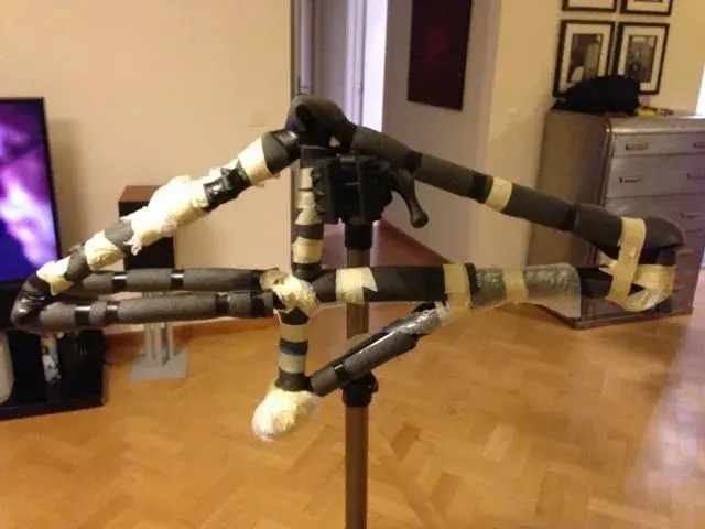

all being well i should have this next week.
bought it off a retrobike member.

you bought an estay frame made of foam...thats gonna flex..ps i have a very nice anodised blue ozone hanging on the wall that my bro got at the malvernes when they started out..
