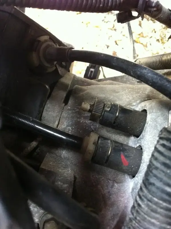

Also just noticed this I am guessing this is a sensor and should be connected to something? Basically bottom of gearbox there is two sensor attachments one has pipe on it the second looks like it should but don't
Any pointers be great?
(Will upload pic later of sensors)

Here is pic

Sounds like an air or vacuum leak. Hard to tell from the pic cos it's too close up, but it looks as if there may be a pipe missing from that stub.

There's definitely a pipe missing there, the end is clean. If you can't find the loose end flapping about go to a garage and "test drive" a similar model so you can see where the pipe is meant to lead.

Picture; it looks like the drainplug of the hydraulic clutch.

Indeed, a wider angle pic would be useful.
