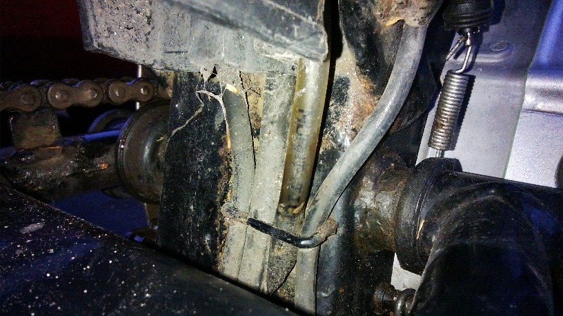

Hi y'all, i gots me a motorbike recently and i'm poking around it at the mo while the weather is good to see what work/maintenance needs doing.
spotted this collection of rust around the rear swing arm pivots and cable brackets.
I got myself some Hammerite direct to rust smooth black, is this stuff alright to use? or is it still worth me wire brushing/light sanding this rust off a bit more than a 'casual' attempt??
is there some sort of rust treatment i can dab on before, then wipe clean and apply the hammerite?
i like doing proper jobs, dont just want to paint over it so you cant see it - unless thats all i need to do to do the job properly of course ;)
pic below of the affected area:

De-Ox gel first.

Chopper1192 wrote:
De-Ox gel first.
will this take any paint off? or just dissolve the rust/soften it so it can be brushed away..???

Various sizes of small wire brushes.......clean off with disc brake cleaner (solvent)........dry and hammerite it.

twain wrote:
Chopper1192 wrote:
De-Ox gel first.
Doesn't harm paint, simply melts the rust away and it can be rinsed clean. Not cheap, but the performance is magical.

lovely. will give the discbrake cleaner method a go first (already have this) :)
