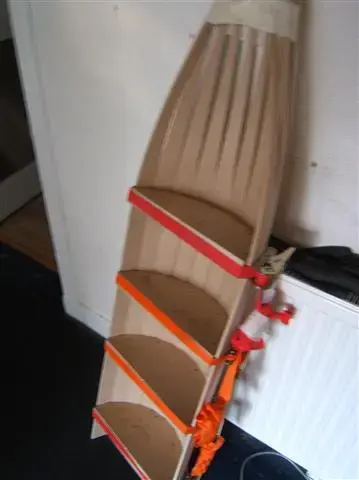

A pic of the current state of play. It should give you the idea of what im trying to get to :?
this is effectivly one quarter. Cheaper making prototypes in part.

PostPosted: Sun May 26, 2013 11:15 am
Joined: Thu Jan 26, 2012 3:46 pm
Posts: 656
Location: Hampshire
You my friend have just given me a headache! Good luck and if you can be arsed please do a step by step photo diary as i find this sort of thing fascinating.
