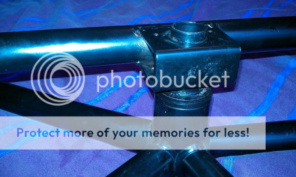

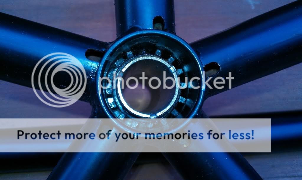

Hi, I have a spinning recliner chair that i am hoping to modify. Trouble is, i can't seem to work out how to remove the swivel from the base. Not too sure what mechanism is in use, but there seems to be too much friction to indicate bearing use. The point of attachment looks similar to the old shimano sealed bracket tools, also, the inside tube has strange "predator" tri marked grooves set into the end. I have included a couple of photo's, so if anyone can throw any light on how this can be taken apart, i would be extremely grateful :wink:
View from underneath:
View from side:

Looks like it's been screwed in then locked by those three nasty grooves - effectively they have bashed the inside.

Grind off the outer tips of the three groves and the base will come off.

looks to have been peened over in those 3 places. be a bugger to get it out without much buggeration.

Could you get in there with a Dremel or summit? :?

A small cold Chisel and hammer would make short work of those tabs, it should then come to bits.

PostPosted: Fri Oct 19, 2012 11:38 pm

..Great stuff, i filed the tips off and tadaaa, it's now off :D
