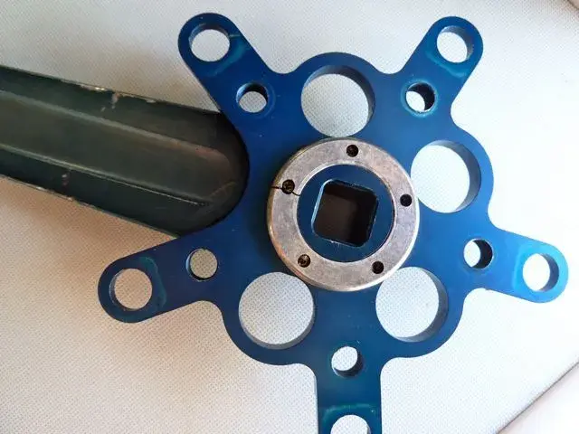

I'm after a machinist who can make me a lock ring for a crank set.
Is there anyone in the retrobike community who can do this sort of thing?
Otherwise I guess I'll just weld it?
(yep ... I've contacted RaceFace and they don't have any more of these)
Thanks in advance for any advice.
Cheers. Frank

There is bound to be a number of people on the forum who can make a lock ring like that, but I would also suggest finding any local model engineers, the kinds of people who make model steam engines and the like.
There are a few forums covering the subject, and some of the stuff those guys can make is incredible. You are also more likely to find someone a little closer to home.
Good luck with your search.

Are you mad? don't use a model railway engineer! a model motor boat outboard engineer, specialising in the accurate scale reproduction of late model 4 stroke Honda outboard engines would be much better!
Any local engineers/machine shop would be able to make you one. Incredible some of there work undoubtedly is, there's no need to tie it down to hunting a model railway fanatic, there isn't a great amount of detail to it.

My money is on the lockring being the same 24tpi thread as a bottom bracket / freewheel. Try any old fashioned BB lockring first...
Good thinking!

Undo all the bolts.Turn it around to put the crack in a non stress area :?
Personally,i cant see it causing any problems unless the crack is in the arm itself under the lockring :?
Have you checked for that?

i can make you a nice shiney stainless one if you can wait just over a month for me to get back from Venezuela i can even make it so you use a spanner instead of the horrid pin holes :wink:
Hi. Thanks for your offer.
(Venezuela!)
I'll look you up if I can't find someone locally.
Do you see any problem with using a stainless lock ring on an aluminium spider?
Cheers. Frank
