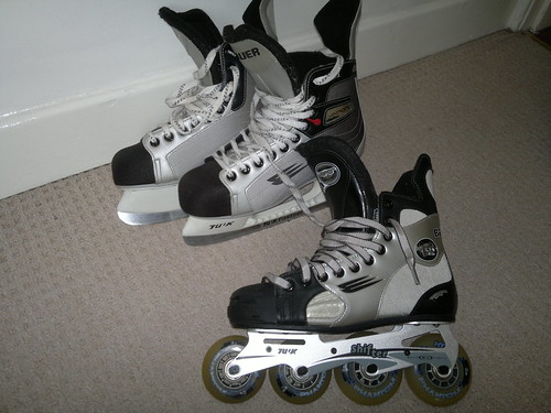

These are they:-
The lower inline skates were a bit small and tight across the ball of my foot, so bought some Bauer Ice Hockey skates on t'ebay, to serve as donor boots to put on the frame from the Bauer inline hockey skates.

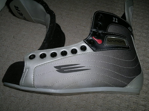

After some power-tool and brute force action, both sets of boots and various frames are now separated:-

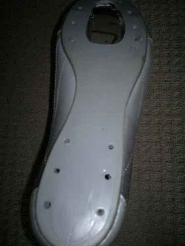

But the rivet / bolt (not sure whether I'm going to reattach with rivets or bolts, yet...) holes from the inline frame don't really line-up with the rivet holes from the ice runner.
So what I wondered - as some of the new holes, would ideally be fairly close to the existing ones, is whether I could fill the holes with some kind of glue / epoxy (I dunno?) that when cured would be just as robust as the rest of the plastic base, that I could drill new holes wherever suited for ideal mounting of the inline frame:-
Is that possible, and if so what would be something good to use?

Main issue, though, is having the mounting holes in the boot base, in the correct place for the inline runners - which really is going to mean filling the existing holes, then re-drilling.
