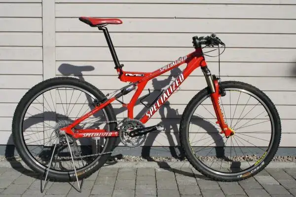

I was wondering if anyone knows anything about this, it looks like it has some holes in the back end for a disctab adapter or something? and are they available?
the whole bike looks neat, it´s an s-works version with xtr and mars carbon fork, but I want to ride discbrakes, cause I just bought some magura martas and this need to be my racebike, want to ride an fs with a lot of air in the rear damper but need it to take out the big strikes from roots sometimes. and it´s probarly lighter then the fs frame I got right now in the shed.
or should I just walk away?

have you a photo of the other side at all.
thwang

Specialized made an adapter, I had one and sold it to a friend a few years ago, they looked like this:-
PostPosted: Mon May 24, 2010 9:25 am
Joined: Mon Apr 03, 2006 5:11 pm
Posts: 1142
I had one of these on my 1999 FSR "XC" - same generation as the red bike pictured above.
They came as standard on the FSR "Enduro" bikes of of the same age and will fit the "XC" frames as they use the same rear triangle.
They aren't as heavy as they look - pretty light really. The one above looks like it is screwed into the top of the canti boss - on mine you removed the canti boss and it came with a screw of the correct thread to fit. On the one above I assume someone has lost the "special threaded" screw and just screwed it into the end of the canti boss.
Ring Specialized UK - you never know, they might have one lying around! Their customer service is pretty good, I snapped the original chainstay on my FSR well out of warranty and they sent me a new one.

This guy:
http://www.retrobike.co.uk/forum/viewtopic.php?t=103266
Has the disc adapter you need!
The rear triangles are the same - the "ground control" had a cheaper main frame and coil shock.
