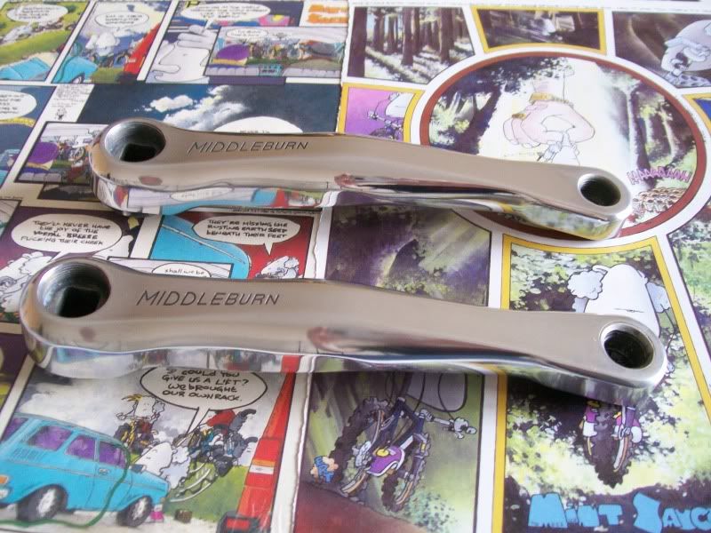

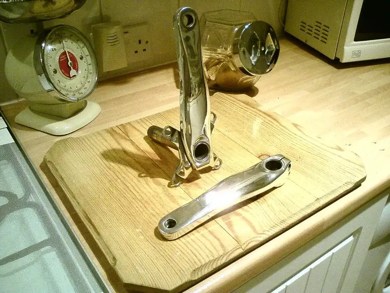

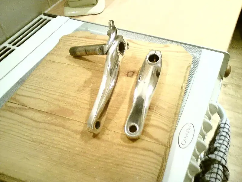

i got really depressed looking at the cranks as they where so scuffed and scratched so after average mark said about someone elses xt cranks being polished and looking good i though bugger it im going for it it took 4 hrs for the non-drive and 5 1/2 hrs for the drive side i started by removing the anodizing and bigger scratchs out with a dremal and sanding wheel with 280 grade papers followed by 320 grade then 600 grade then 1200 grade then 2000 grade using disc brake cleaner as the solvent to keep things going as the grit papers where wet+dry after all the surface imperfections where removed and then polished with soft cloth and autosol to achieve the best possable finish i could get and i got this

this is the last set I did down to 400grit .

And an almost empty biscuit jar! Looks nice though, top job.
PostPosted: Tue Feb 09, 2010 12:41 pm
Joined: Thu Apr 24, 2008 4:24 pm
Posts: 896
Awesome stuff. How long did the biscuit jar and scales take, or were they a trial run?
PostPosted: Tue Feb 09, 2010 6:54 pm
Anglian AEC / Prison Ship Captain
Joined: Thu Mar 15, 2007 1:26 am
Posts: 6051
Location: LOWESTOFT the worlds smallest bore fest
just a trial run to see how good they would look no biscuits my missus and mother have put me on a diet iv'e gotta drop from 12 1/2 st down to 11 st :cry: :cry: :cry: :cry: so im no longer "lovin it" with the golden m :lol: :lol: :lol:
