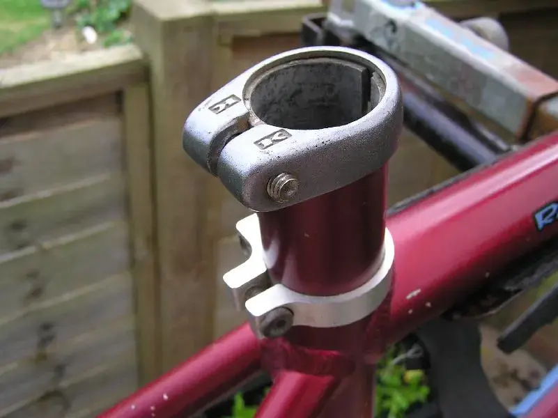

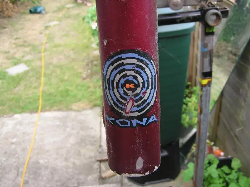

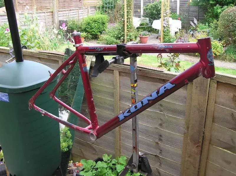

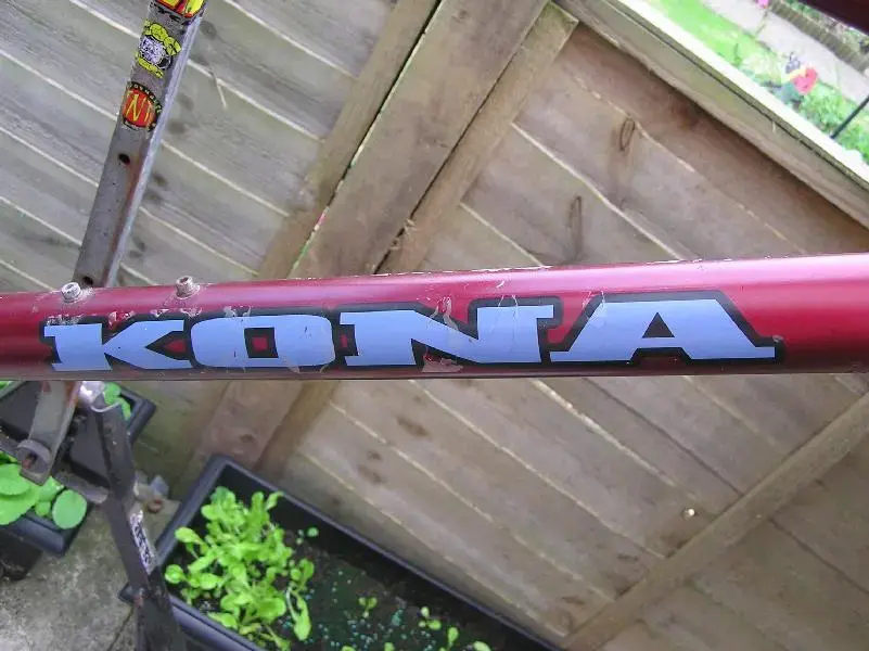

took a punt on ebay on this and it should come up ok. going to get it powder coated white, and add some new decals. luckily it came with the all important brake stop collar thing and the seat clamp.

nice frame, nice colour (96 satin red), quite rare I guess, Koas where not offered here in Austria BITD :o
original specs (c) Bike Pedia:
Weight 25.2
Sizes 14", 16", 18", 19", 20", 21"
Colors Red, satin
Frame & Fork
Frame Construction Welded aluminum
Frame Tubing Material 7000 aluminum, double-butted
Fork Brand & Model Kona Project Two Sport
Fork Material Chromoly, unicrown crown
Rear Shock Not applicable
Components
Component Group Shimano STX
Brakeset Shimano STX M-System brakes, Kona Race Light High Command levers
Shift Levers Grip Shift SRT-400
Front Derailleur Shimano AceraX top-swing, bottom-pull/clamp-on 31.8 mm
Rear Derailleur Shimano STX
Crankset Shimano STX, 22/32/42 teeth
Pedals Fasten LXT w/clips & straps
Bottom Bracket Shimano BB-LP26, 113 mm spindle
BB Shell Width 68mm English
Rear Cogs 7-speed, 11 - 28 teeth
Chain Shimano CN-IG31, 1/2 x 3/32"
Seatpost Kalloy SP-243, 27.0 mm diameter
Saddle Selle Italia Triax Racing
Handlebar Kona Slim, aluminum
Handlebar Extensions Not included
Handlebar Stem Kona Race Light Velocity
Headset 1 1/8" Kona Race Light Impact
Wheels
Hubs
Rims Mavic 238, 32-hole
Tires Front: 26 x 2.10" Kona Sniff, Rear: 26 x 2.10" Kona Scratch
Spoke Brand DT Competition stainless steel, 2.0mm double butted
Spoke Nipples Brass nipples
did I mention somewhere else, that I like 96 Konas :wink:

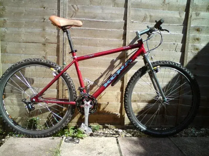

I have the exact same frame/bike. It makes for a really great ride and is probably the best handling bike I've ridden, very underated I think :wink:

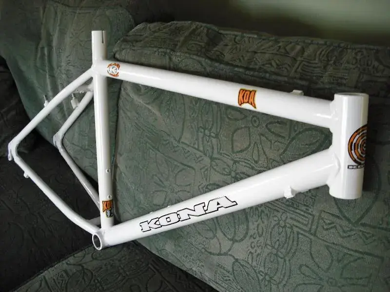

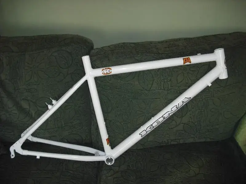

fresh from the powder coaters.

That looks a million times better 8)
You cant believe they were the same bike .well done to the P/C's and a damn good choice of colour.
What spec and dressage are you putting on?
Going for the Black/White contrast,or something different :?
