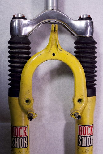

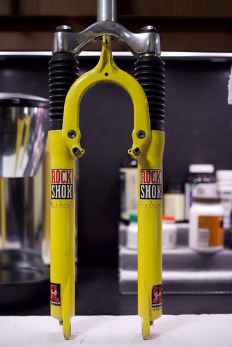

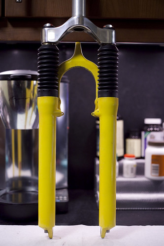

It's time to resurrect this old Judy SL as it would look smashing on my Voodoo (that it originally came on). It's got some issues though. One of the brake arch bolts has been missing for a while (the head broke off) and had no idea what to do about it since they are pretty special. A friend of mine was digging around his wealth of parts from his days as a mechanic and found two brand new bolts! I figured with that kind of luck this fork needs to see some action again. I spent an evening restoring the exterior as well as I could. Here are some photos of the before and after.
Before and after.
Image Image
Image Image

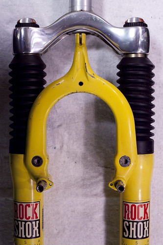

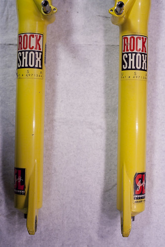

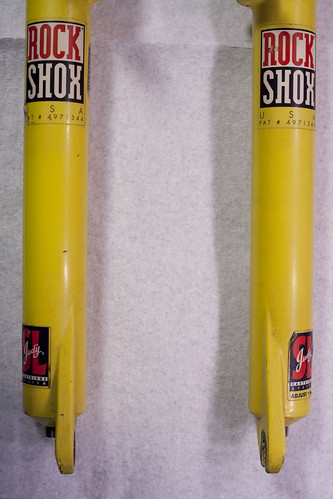

Here are a few more shots of the fork.
Image Image
By the way I have tried scrubbing these forks down with soap and water before with relatively bad results. This time I used Maas metal polish to clean them. I tested an area that wouldnt be seen first to make sure no paint would be removed and lo and behold it took off the stubborn grime I thought was part of the paint forever. My one caution is that it did seem to remove a very very slight amount of paint, so be sparring with the polish if you try this method.
