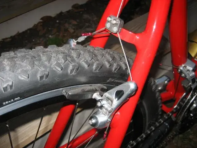

Bicycle brakes are funny things. On the one had you hear all sorts of design and engineering talk about mechanical advantage, and cable pull ratios and stuff like that, but in reality, the number one issue behind why brakes either work or don't work, is installation. Disc, V-style, or cantilever...do it wrong and your brakes will suck. Do it right, and you'll stop on a dime every time...even with cantilevers. 8) Even the best designed brake can only overcome so much poor wrenchmanship. Cantilevers, for all their seeming simplicity, are actually the most complex brake to install and adjust, and in that, they opened the door for the V-style brake, with it's touted "mechanical advantage". The variables for cantilever brake strength and modulation are many...the height of the hanger over the rim, the amount of exposure of brake pad post inside the brake arms, the amount of toe in the pads. Shimano tried to standardize some of these things with their fixed length straddle cables, but with little improvement. The Dual-Eez solved all the deficiencies of the cantilever brake, unfortunately though, back in 1995, the cantilever brake was about to become a thing of the past...
This picture shows the Dual-Eez installed on the back of my Beast of the East. Eagle Klaw pads, and Deore DX cantis are also shown. Notice that in the picture, all cable lengths associated with the install ARE PERFECTLY STRAIGHT...No curved cable. More on that in a bit...

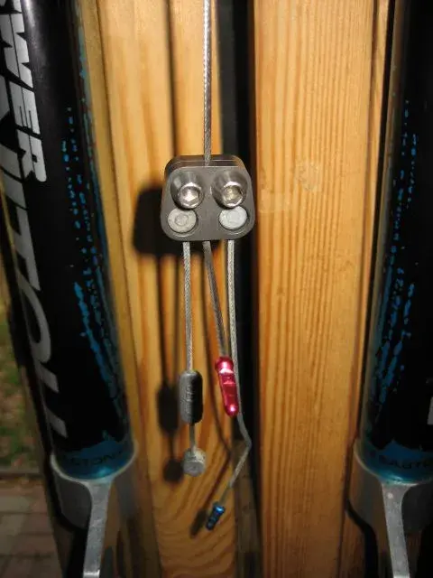

In this picture, taken of a cable setup ready for swapping in my Manitou 3 fork on my Beast, you see one of the other great freatures of the Dual-Eez. Full Floating Cables. Full floaters allow for the staight pull lengths of cable to all remain precisely that, throughout the function of the brake...Straight! On the left, the floating cable is a Shimano type fixed straddle segment, 73 length. On the right, a length of old brake cable, the cast head in the Dual-Eez, and the other end free to be bolted to the Deore DX canti arm. In an installation where both cantilever sides have quick releases, both sides would be fixed length Shimano style straddle cables.
Here, both cables hang freely in the hanger, free floating, ready for install.
Seems pretty crazy to mention straight pull cables, right?...but think about the myriad of cable hangers out there...most of them rely on an arched over the tire, single straddle cable. More on THAT in a bit!

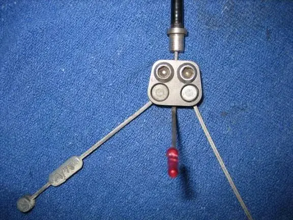

FIRST PICTURE. Shown here, the Dual-Eez cabled set-up ready for mounting, the same as in the previous picture, but splayed out as they would be on a bike. Juxtaposed with the previous picture, this does a good job of illustrating how the cable ends float in the hanger.
SECOND PICTURE. To facilitate the Dual_Eez installation on the many different lengths of cantilever arms, and frame configurations, different straddle cable lengths can be used.

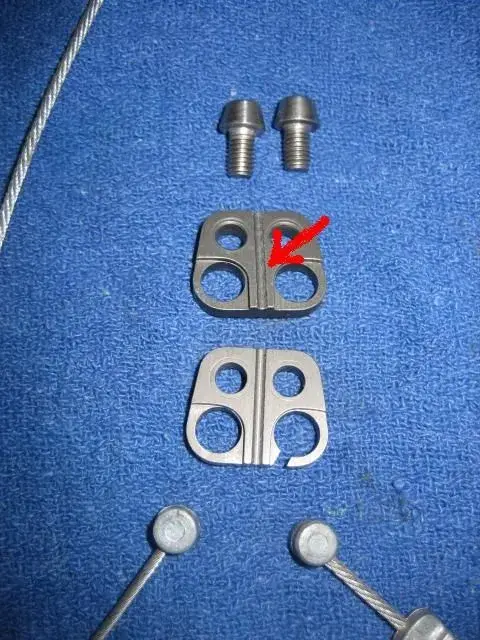

Exploded View!
2 quick releases? You bet! This is a second Dual-Eez set, a spare, that features an additional quick releas slot, to allow the adjustable length cable to release from the hanger itself, the anchored arm. This is a handy feature, as on some frames where space and clearance are an issue, or where the tire in use is a wide sucker, the single sided release install doesn't allow for the brake pad on the bolted, anchored cable side to swing far enough away from the wheel to allow the tire to drop. Releasing the left side fixed length cable quick release from the canti arm, AND releasing the right side adjustable cable length from the hanger itself, will allow for the fitting of the fattest tires possible...got any 2.5 Ground Controls lying around?
This may seem like a worthless feature, but keep in mind, this multiple release option is important on a hanger design where the hanger centering is fixed. Anyone use a Tri-Dangle? Know why most folks don't use the two outboard straddle cable set screws?...because if you fix the hanger in the middle of the straddle cable on a Tri-Dangle, you have the same problem...can't get the wheel out. No option for a 2nd quick release cable with a Tri-Dangle.

Same Picture, but illustrating the brake cable mounting design.
Again...picking on the Tri-Dangle (which admittedly is probably the second best hanger available...a great design in it's own right), one of the design goals for the Dual-Eez was to create a cable mounting process which would not degrade the cable itself. Pinch bolts, Tri-Dangle set screws, etc...do a boat load of damage to the wire strands that make up a braided cable. In all other instances, tightening other hangers on to the brake cable means crimping the cable itself, and rendering it essentially a single use and replace item. These crimped mounting points are also the place where most broken cables occur. What if you didn't need a mounting bolt or a set screw to hold the cable?
The Dual-Eez uses a split body design, which sandwiches the cable in a slotted channel in center of the hanger itself. The two halves of the hanger are then held together by two stainless cap screws (custom tapered on a lathe). Imaging holding a piece of rope between your hands, pressed palm to palm. Not too stong, eh?...BUT then BOLT your hands together. Darn strong, and the rope sees no damage whatsoever! Same for the Dual-Eez and the brake cable. Take the thing apart and the cable is no worse for wear.

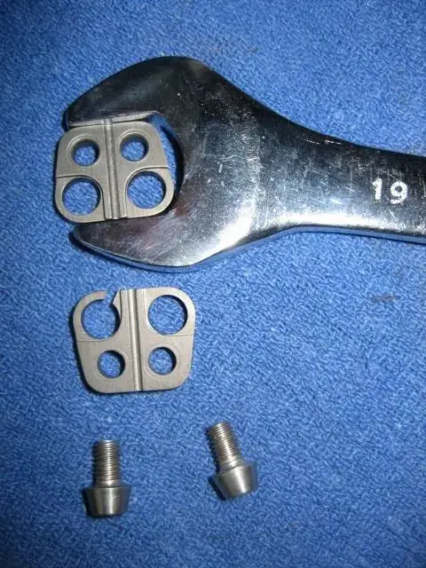

Because the brake cable is pressed between the two halves of the hanger body on a Dual-Eez, and because the cast cable ends are free floating within a completely assembled Dual-Eez hanger, it is IMPERATIVE that the two halves of the hanger bolt together flush. (note in the installed picture in the first post, you'd never know the Dual-Eez is a two-part hanger.) They must be flush.
To give you the leverage to get the two pieces flush tight, the Dual-Eez is sized exactly 19mm in height which allows for a flat wrench to hold the body of the hanger firmly, while you torque down on the two stainless cap screws.
If you're wondering how these little babies can take all that torque and force, Dual-Eez are machined from forged aluminum, and then given a military hardcoat anodized finish. This means that while you can have any color you want as long as its Battleship Grey, they are nearly indestructible.
