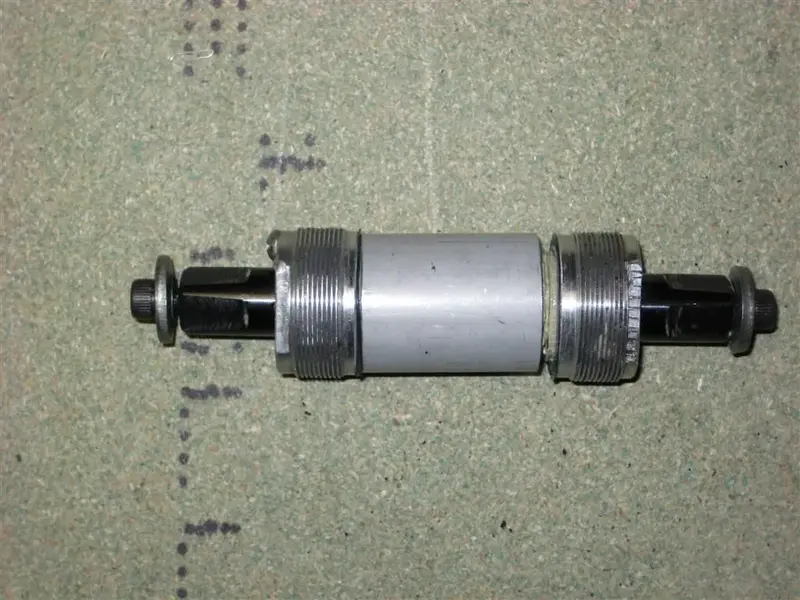

Searched the forum & could find no reference to these. I used this with my first pair of cooks CBR cranks on the FRO. Needle/roller bearings rather than ball. Grease injection was a revelation after the porous BB seals on the previous bullseye cranks.

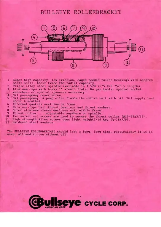

The original tech sheets
