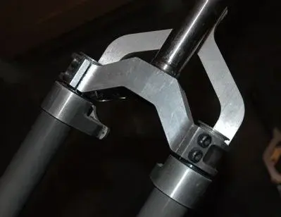

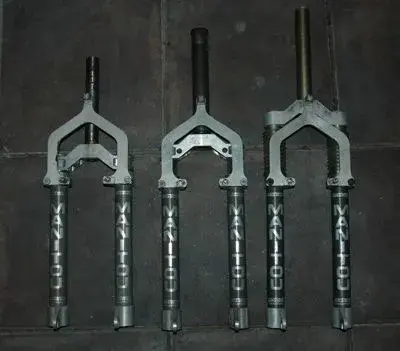

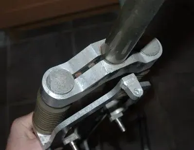

When I placed my three Answer-licensed Manitou forks together I realised how different the braces were - anyone know the time line or have any other versions of the underside milling/bolt arrangements to show?
Mr K
PS. Pics follow in batches... and yes, I know which ones are back to front already...

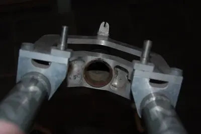

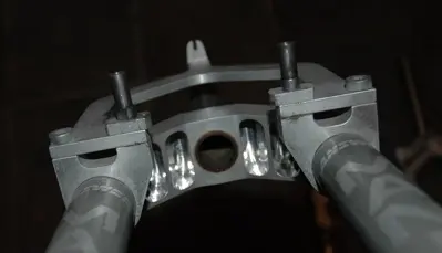

M1 A set

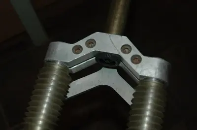

M1 B Set

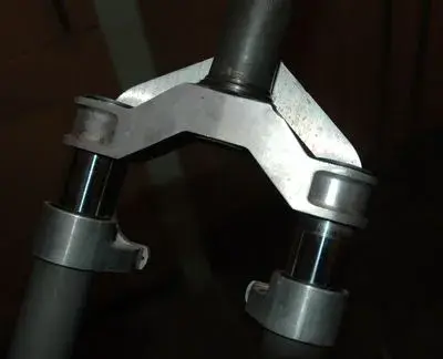

M1 C Set
PostPosted: Tue Jan 20, 2009 1:19 pm
Joined: Fri Nov 23, 2007 10:35 pm
Posts: 2048
Location: Vienna, Austria
afaik c has the original fork crown. the others are fork crowns of later production.
PostPosted: Tue Jan 20, 2009 6:44 pm
B.o.T.M. Winner / Feature Bike
Joined: Tue Dec 13, 2005 3:26 pm
Posts: 6277
Location: Tilting at windmills and shouting at the rain.
That's what I'd say. a looks to be a Mani3, b looks to be Mani2, only c is a Man1 crown same as my Bradburys and my Mani1s
PostPosted: Fri Jan 23, 2009 3:13 pm
Joined: Fri Jan 26, 2007 9:58 pm
Posts: 681
Location: USA, sigh...
my M1 crown looks like C as well...
no pics of the crown underside, but there's a shot of the fork in this thread:
http://www.retrobike.co.uk/forum/viewtopic.php?t=32740
my brace is very different...aftermarket i guess?
PostPosted: Fri Jan 23, 2009 10:26 pm
BoTM Winner
BoTM Winner
Joined: Sun Apr 20, 2008 9:13 pm
Posts: 986
Location: Aspen Park
Yeah. C is a real Manitou crown. They came on the pre-Answer Manitou. It is the one!
PostPosted: Sun Jan 25, 2009 8:59 pm
MacRetro rider
MacRetro rider
Joined: Thu Jul 31, 2008 1:45 pm
Posts: 2800
Location: Near a tree, by a river in a hole in the ground....
My Mani 1 crown which was an early version (from some rich schmuks race rig BITD) is distinctly C
It's now cracked at the bolt holes and across the top where the steerer enters - was going to get my mate to CNC a new one off pattern, seeing as thats pretty much all it was......
PostPosted: Sun Jan 25, 2009 11:00 pm
Joined: Tue Aug 05, 2008 1:10 pm
Posts: 1743
Location: Peoples Republic of Scunny
All the braces look the same! :wink:
Agree with the above posts that C is an origional crown and all the others are from later models(2's or 3's).
