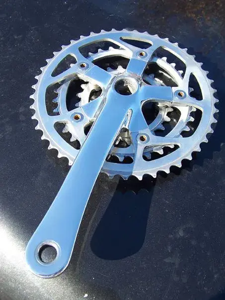

Have I done the right thing guys or should I burn for this ?? They did need restoration either way !!

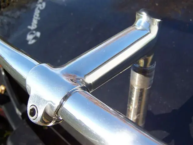

Im particulary proud of that shite Kalloy stem though !! Like the homemade butter welds !! You would never know I was a Klein nut !!
As for the cranks they were in a bit bad shape so needed some TLC !!
P.S Thanks to OldSchoolPete for the original Rock Shox decals :wink:

Kalloy whoopsy

m900

Nice bit of polishing!
Have some M900 cranks very similar :)
Have you coated the RS with anything? They will corrode lots in not lots of time otherwise - I know, tried it! :)

To get the Rock Shox like that Pickle I firstly Took em to bits, used paaint stripper on the legs which works a treat! Then I used various grades of paper to sand them back finally finishing up with 1200 grit then some serious polishing with a car polishing mop with foam head and shit loads of Brasso !! Which works damn well on Aly by the way !! :wink:
Ha ha, well noticed my Littlefluffychicken !! However they are only temporaries whislt scouring Ebay for some nice Tit ones !! Anybody got some for sale ???
Cheers for al the good comments though guys !! Got the bike near back together now. Did exact to the frame as the Rock Shox and it looks ten times more shiny than from the factory !! The aly is super flat and therefore like mirror !! Pics to come soon :wink:
