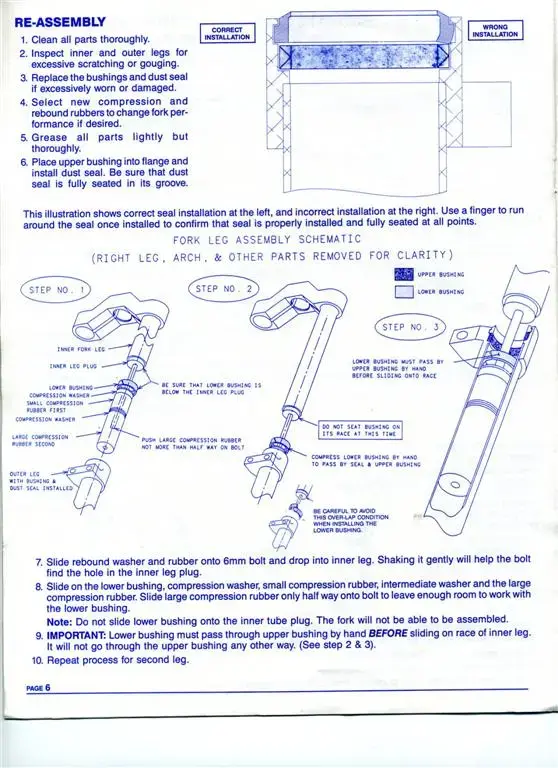

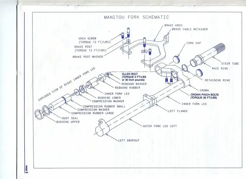

should help ..........

You'll probably find you have a 'puddle' of degraded elastomer in the bottom of your sliders and another small puddle in the staunchions (top-out bumpers). You can use heat to get it all out but I just scrape as much out as I can.
When you're re-installing, put the slider bushes and seals in place and leave the staunchion seals just off the bottom of the legs (held in place by the elastomers) so you can slide them past the slider seals and bushes. The staunchion bushes will slot onto place when the elastomers contact the bottom of the sliders.
