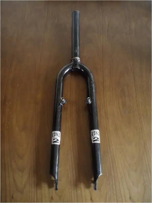

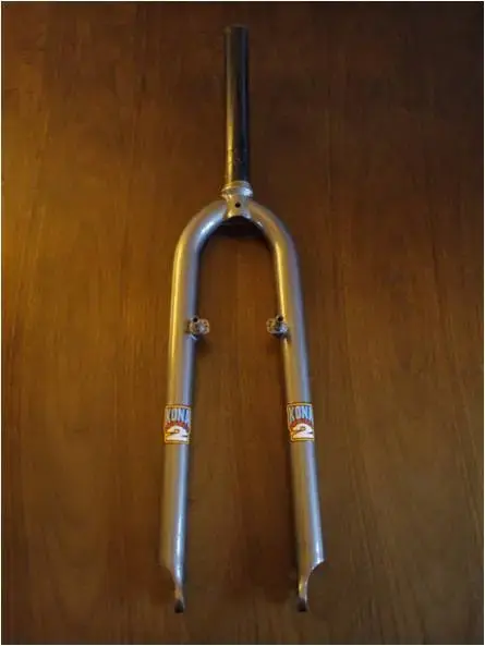

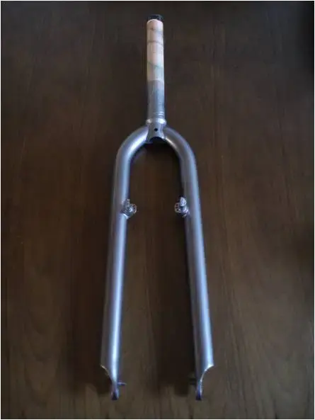

So I needed some P2's for my 1997 Kula build and I managed to get these for £5 BIN :shock: off ebay! They are even tripple butted :D but in that daft modern black colour, so I set to work on them..
File comment: Hmm, these seem a little modern..
File comment: Ooops, I seem to have spilt a little nitromors on them, how clumsey of me!

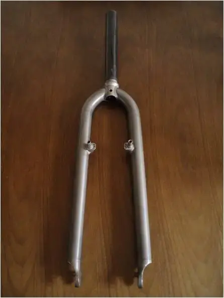

File comment: Oooo.. check out the lovely naked steel...

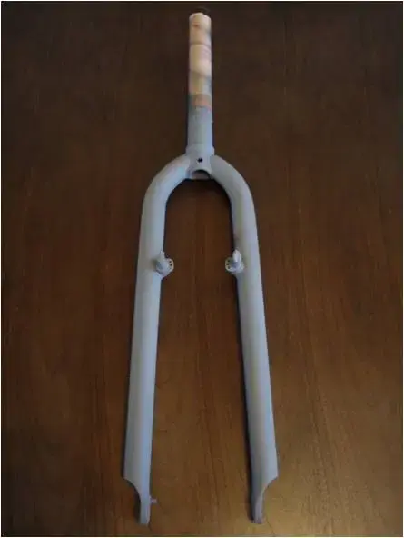

Continued...
File comment: All primered up!
File comment: A touch of Rover Gunmetal me thinks...!
File comment: Slightly more retro in apperance!

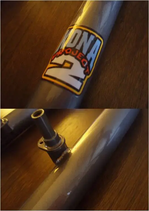

File comment: Hmm detail..

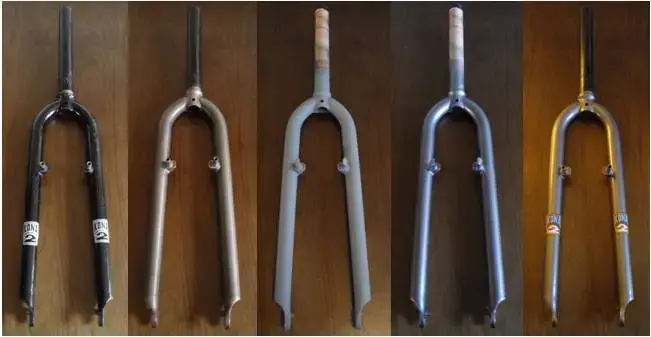

And the before, middle and after shots..

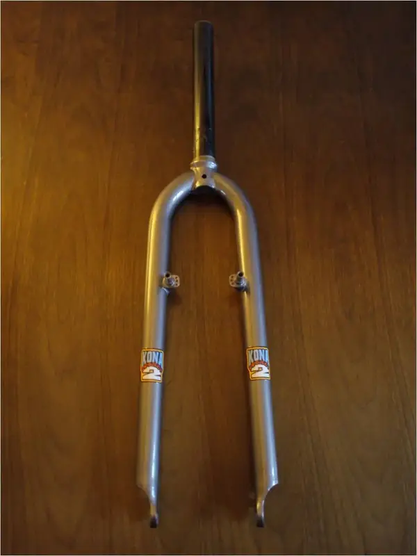

Here a slightly higher res of the finished article..

Another great paint job. Did you manage to get that finish with a spray can or something more sophisticated?
PostPosted: Tue May 27, 2008 12:21 pm
Joined: Mon Jan 07, 2008 3:59 pm
Posts: 1093
Location: Nottingham JustGoRide.co.uk
Just a spray can, from halfords :roll: ... and loads of care and attention between coats.
Once stripped I applied two coats of primer, flatting off between coats, then about four coats of the gunmetal, again sanding between coats. Finally I very carefully sanded (1200 grit with loads of water) to matt of the top coat and applied laquer. Stickers were applied between coats of laquer.
