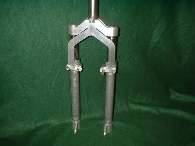

now you all know how much i love my manitous , so ......................
the ones i lusted after for sooooo long 8)

nice one .
it seems in very good condition .

externally they are practically perfect , and once i cleaned and stripped them they were almost perfect inside too
the long bolts had gone a bit rusty , from some water which must have gotten in at sone point , but after a quick rub over they were good

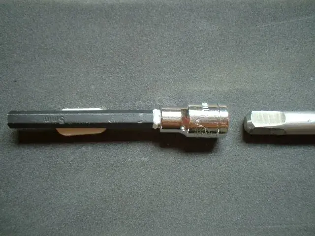

attempt at making a tool for manitou 1 and 2 .................
for anyone thats stuck without one .......................

measure the internal fork diameter, then fit a circular disc of that diameter around the shaft of the allen key. when u insert the allen key it will be perfectly centred due to the disc & help you locate the bolt at the bottom of the internals :)
