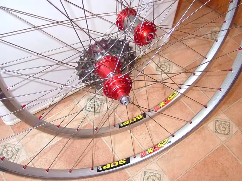

For years I have always wanted a set of wheels built with red HOPE Ti hubs. So for my latest build, a NOS 1999 Kona 853 Explosif, I have finally got them at long last!
Firstly I decided on 32 hole Mavic 517 SUP rims, which I bought complete with Shimano XT 750 hubs in mint condition. I then spent months looking for a set of retro HOPE hubs in anno red.
Gave up and just bought a red front one and then a rubbish set of mixed rims came up with the dream set of mint hubs! :D
I bought this set and sold the first HOPE front hub.
Just collected the built final wheels today and I am very pleased. Bit of a hassle and huge expense getting them exactly how I wanted, but who said perfection was ever going to be easy and cheap. :oops:
Final spec:
Rims - Mavic 517SUP - 32 hole
Spokes - DT Revolution
Nipples - DT anno red alloy
Hubs - Retro HOPE ti in anno red

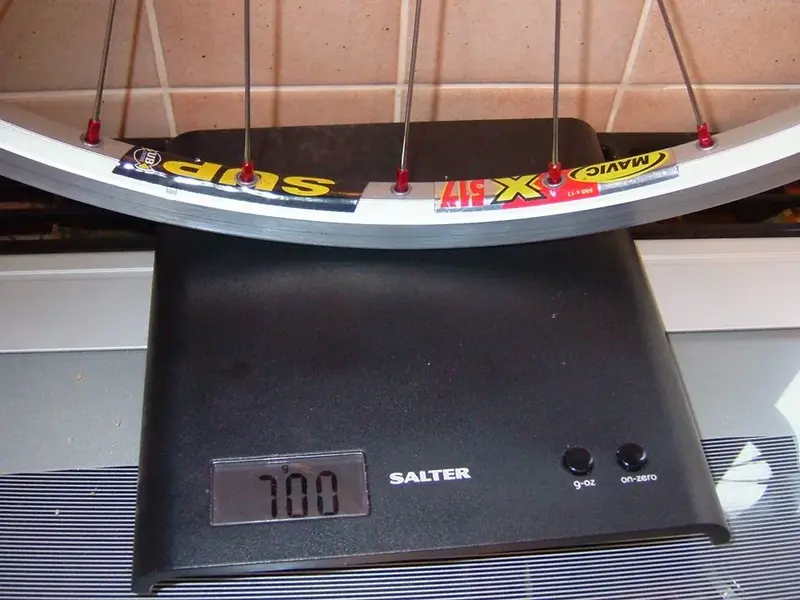

The revolutions save 100g over a set of DT competition spokes and the alloy nipples save 40g. I wouldn't normally recommend alloy nipples as they can corrode and stick, but for a custom light use build its ok.
Just weighed the front wheel and its 700g exactly - NICE! :D
What is your idea of a dream set of wheels?

Thanks for you comments, these wheels have been well worth the wait.
My local wheel builder supplied the Revs and DT Nips. The Revs were 99p each and the Nips 35p each (but I had to buy a box of 100 nips though, plenty of spares now!)
Be carefull who you choose to build wheels with Revs as its harder and takes a lot longer than if using normal DT spokes. He charged me £25 per wheel to build, not bad I think as they are perfect. :D
ps I have Mavic 230s on two of my other bikes, and I agree they are very nice and very light. Decided on 517's this time as I simply love the shape of them.

I'm sorry but there are some odd rim choices going on here... :shock: 217's I can understand I've got a pair (sunsets) built up on Hope Ti hubs long lasting great rims. 517's these were made outta the softest cheese alloy ever... lasted one winter of road riding before the braking surfaces were shot, hopeless I've never known a rim wear out so fast as a 517. 230 TIB these things can't resist pringles...

'Fuzzywig' you are 100% correct, these wheels were never designed to be an everyday all weather 'hack' wheel. There are plenty of stronger heavier Mavic wheels out there for everyday use.
At the time Mavic introduced the X517 it was what I considered to be the best mountain bike rim money could buy, but never the strongest or most durable. The X517 rim is made from Maxtal, Mavic’s proprietary 6000 series aluminum alloy. It is 21.8mm wide and weighs 395 grams. The sidewalls are machined parallel with small groves to improve braking performance.
'Dream' wheels, especially combined with REVS and alloy DT nips are never going to be an everyday wheel as the priority is light weight, looks, feel and race performance for pleasure use only on a superbike build.
I know this may not make sense to a lot of practical people out there, but its like buying a Lamborghini, the car is totally useless and hopeless as an everyday car, but is at the top of most peoples wish list as a 'dream' sunny Sunday pleasure car. :wink:

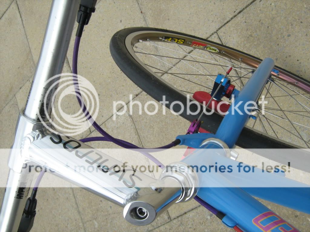

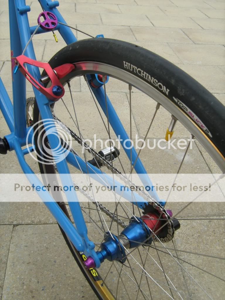

'hack' wheel you offend me sir :D
This is not a hack wheel... This was soon after it was built but it's still going strong still straight, still has life in the braking surfaces. Mavic 717, Ringle Superduppabubba, red ally nipples, revolution spokes, hybrid crowsfoot lacing. There was a reason for the 517's fast replacement... 717's are still going strong.
the rear was a 317 stronger>NO heavier>YES... garbage rim! split at the join.
I'm not out to upset people but mavic upset me when I spent a fortune having a set of wheels built up with 517's only to have to scrap them after about 18 months, I leant to build my own after that, now I have lots of fun with hoops... I even rebuilt the Hope Ti glides with the 217's which were replaced with the 517's
