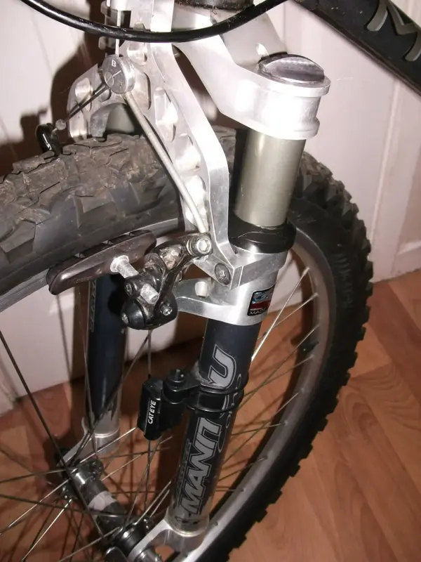

Just re-laced my early 90's Manitou Comps with new Elastomers, Top and lower rebounds from SuspensionForks.Com. What a treat, like new!,
File comment: Stand to Attention!

What's the bike? Do you have a full STX special edition groupset on that? Marin?
PostPosted: Sun Jan 02, 2011 12:01 am
Joined: Tue Dec 07, 2010 11:49 pm
Posts: 19
Sam, Full STX SE laced onto Marin Bear Valey SE 1994, original spec, added Manitou Comps, XTR Pedals and BB, Best bike ever owned, still selects every gear. Photos to follow
