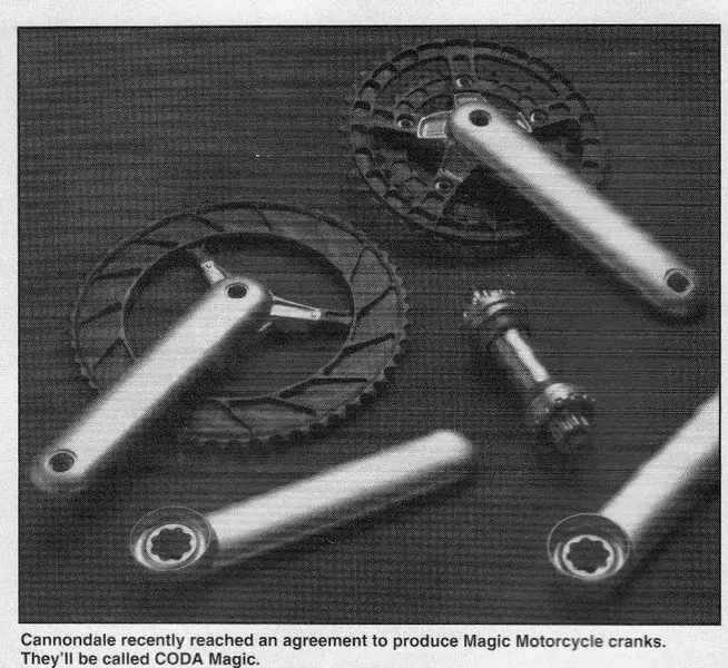

Well, I've had an opportunity to buy one, like that one on the photo (not mine), but the seller had only crankarms (left+right) and the spindle/axle. There were no bearings, bearing cups or bolts which attach the crank to the BB.
Is it possible to get these missing parts from somewhere or did I miss something. Are these crankbolts somewhat special (different)? Has anyone a service guide or an exploded view of this crank?
Thanks in advance
Regards
Lukasz

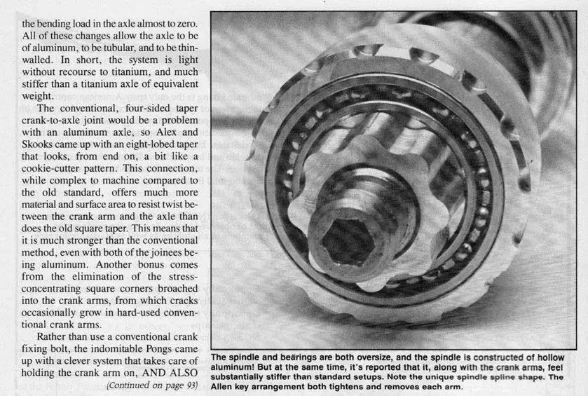

the crankbolts are different, they bolt into the BB axle and o into the crank but the part which goes into the BB has a bigger section. The other half of the bolt is smaller in section and it threads into the crank arm.
Cups are custom made for CODA magic cranks while spare bearings can be found in any shop.
In brief, if you don't have everything, it's difficult to find spare parts.

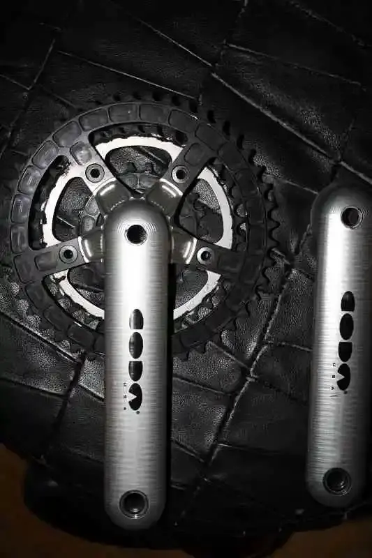

Here's some pictures of the special bottom bracket for your crank:

Well, I've found out that these bearings are 6805 that gives 25x37x7mm (according to www.cannondale-parts.de). What is exaclty what have new Shimano cranks with integrated axle :wink: .
I think that I could use "Big S" bearing cups 8) with this crank, but would like to know more about these crank bolts.
I'm not sure but if I see correclty - they have two threads? (one for the BB and other for the crank arm), how does it work - is it left and right thread or something?
Well, the best would be to measure this bolt, someone? :wink:

yes two treads... I can't figure out how it can work, tho...
