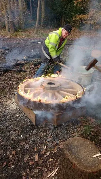

File comment: Hot wheels!
Heated the tyre up in a bonfire until it was glowing red hot. We used a tractor to lower it onto the prepared oak wheel, tapped it one, then quenched it.

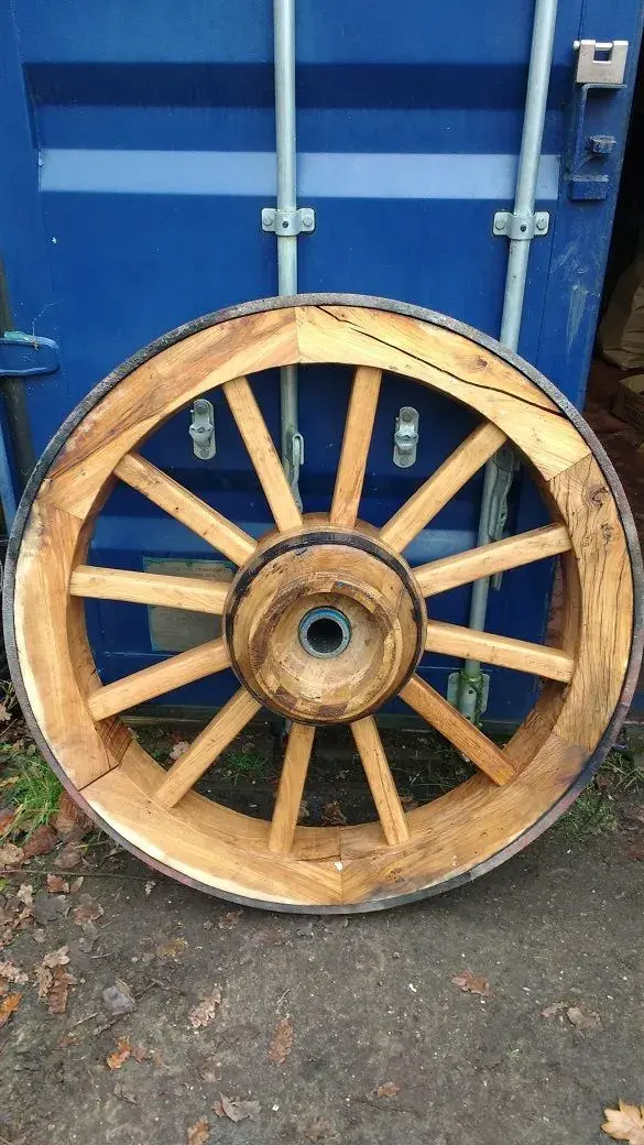

File comment: tyre shod wheel

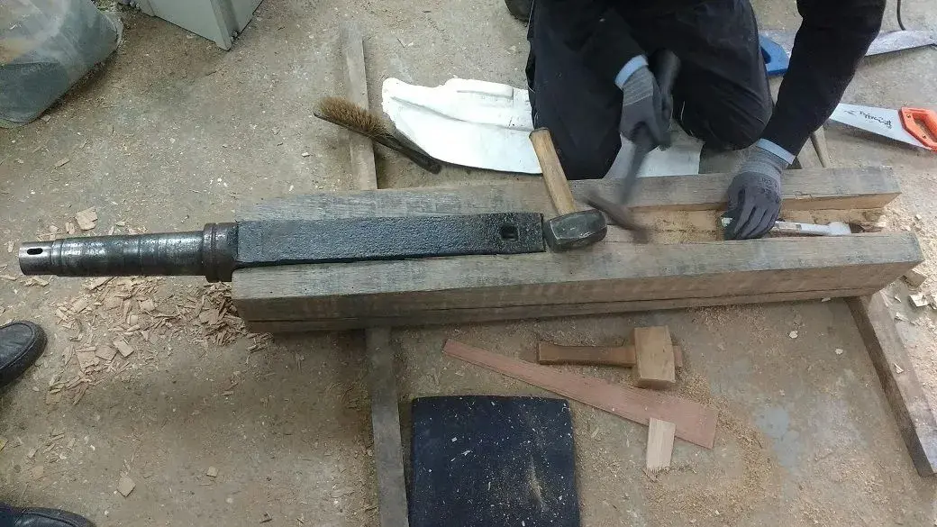

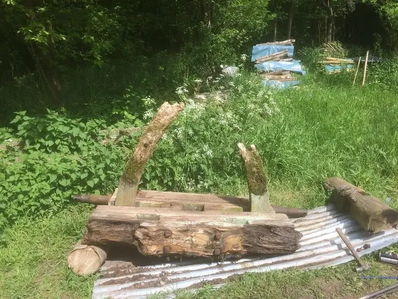

I volunteer in the local woods that i use to ride. We do a lot of logging - clearing out plantation pine to create halos around deciduous trees. Anyway, in a nearby field was an old oak logging wagon that had rotted away over the years, but the metal work still survived. A group of us are in the process of rebuilding it.
File comment: Chopping out spoke mortices in the hub
So far we have built the back half, and have just started on the front half.

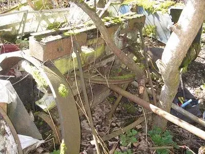

This was the back half as found.

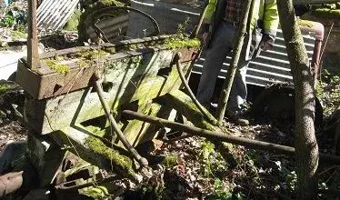

This was the front half as found.

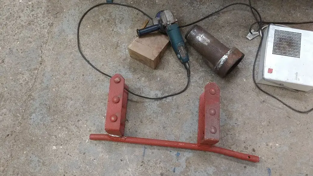

Preparing the beam axle to take the stub axles. The stub axle bearing face is very worn and pitted on one side. Still to decide how best to mate this to the hub bearing. The stub axle is set into the beam slightly off horizontal to introduce a camber to the wheel.
File comment: stub axle and axle beam
The hub bearing was sheared into two parts, which have now been welded together. This hub bearing will be press fit into the hub. There is a lug to one side which keep the hub and bearing as one rotating unit.

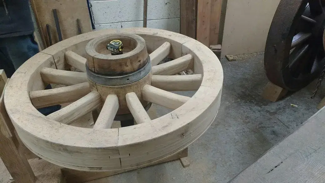

Front hub with a hub bearing pressed in, spokes and felloes (rim), sitting on a stub axle. Ready for tyre to be fitted. Dry fit to allow movement.
File comment: completed wheel, waiting to be shod.
A short hold now - awaiting next batch of blanks for the spokes and felloes (rim). Most of the wood has been very generously donated by Whitmores english hardwoods based near Hinkley. Amazing place to go and visit, particularly if you after some english hardwood. Primarily for large scale bespoke commercial use, but they are very accommodating to the small fry. My son and i sourced some wonderful flamed maple offcuts to make a guitar ('Dad can we make a guitar') thread from a few years back. They simply could not have been more helpful.

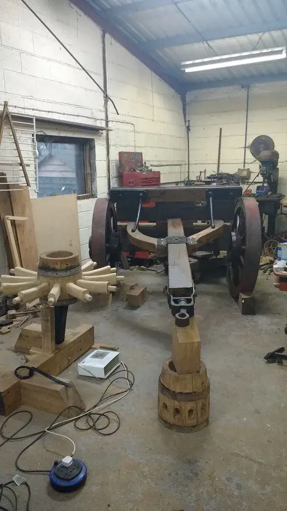

Forecarriage attached to rear and awaiting wheels

Wheels successfully shod last week, and hopefully fitted soon.
Starting to construct the shafts into which the horses will be attached. On the lookout for four shire horses!
