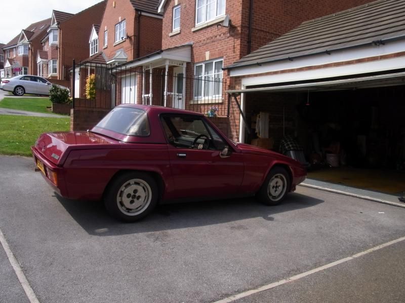

¾ view - one of the best views of the car I think. The car is generally considered to be ugly in the extreme & a hideous thing to drive - while I don't think it's the best looking car in the world it certainly isn't the worst looking car I've ever seen & it's great fun to drive which, surely, is the whole point of a car like this??

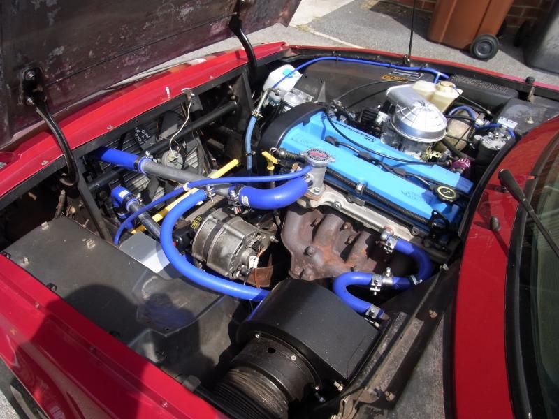

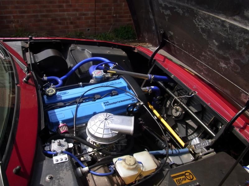

Engine - inlet side
Engine – exhaust side

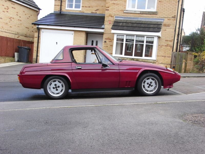

Side view

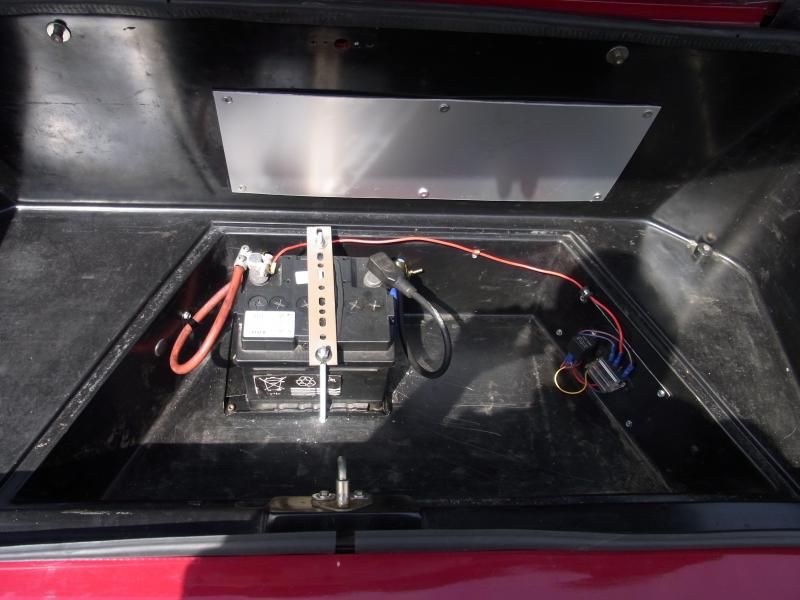

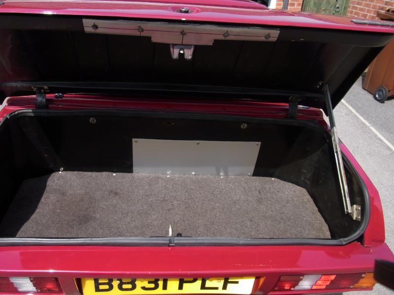

Boot - there’s a compartment underneath the boot floor that holds the battery, fuel pump relay/fuses & tools. So the space you see is the space you can use for luggage carrying, it’s surprisingly roomy. The alloy panel allows me to access the petrol sender without me having to remove the whole boot box.
The under floor boot compartment minus tools

i would suggest either clamping the battery at the base - you can get clips for that or else put a rubber hose over the mechano strap - you would not want the strap and positive terminals touching should the battery move under the awesome g-forces.

The battery is clamped at the base (you just can't see it in the photo) & I've used a length of old inner tube to insulate the bar. Thanks for your concern but I doubt if the car would have passed the MOT if the battery hadn't been secure, or if there was a serious fire risk - believe me the last thing I want, after 4 years, is for the car to go up in smoke!! :)
