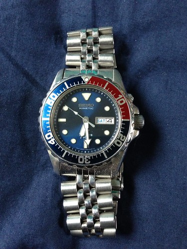

Hey Dave, how much would you charge for an overhaul & new capacitor? Had this for my 21st birthday back in the mid 90's and fair play, it's stood up to a fair bit of abuse including scuba diving, but its looking a bit tired and no longer holds charge and I was gonna buy & fit a new capacitor kit but might treat it to a bit of tlc like you've given the one above ;)

Unfortunately this one is still running slow with no more room for adjustment so I stripped, cleaned and re-oiled it earlier. During the strip down I dropped a wheel and spent the next hour on my knees searching for it but the carpet gremlins had already eaten it :evil: . A new transmission wheel is in the post and then I'll know if its in good health...
