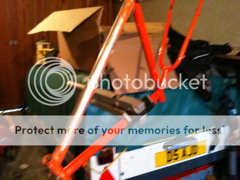

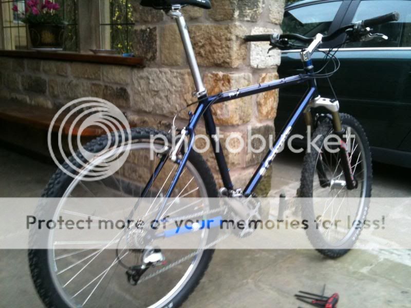

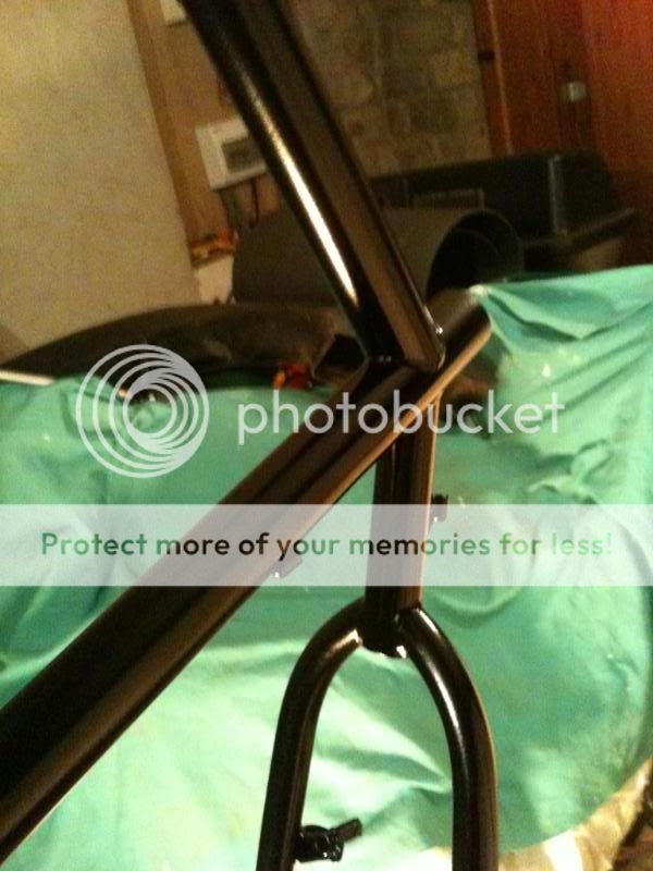

I used to own a p7 years ago and fancied one again, thats where i came accross you fellas, bought the bike about a month ago with the intention of riding as is but got carried away and had loads of old bits lying around in the garage, heres how the build went
A bit rough but solid 94 orange p7 bought off ebay
Stripping with nitromores
Bare metal, surprisingly rust free
Etch primer
Black base coat
Metallic blue pearl, decals and lacquer on

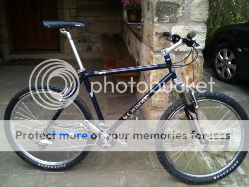

Finished
i know its not entirely period but i wanted a cheap build using items i already had or could get hold off cheaply!
just needs a back wheel to match the front now

very nice. I've been holding off doing a rattle can spray job at home because I thought it was too cold for the spraypaint - is your garage heated?
I wish!, just used an electric heater, the important thing is using quality paint and 2 pack lacquer, i hope it is going to be durable enough!

Gave the bike its first ride out on saturday and chuffed to bits but i find myself hankering after a nickel one, anyone fancy swapping/dong a deal on frames?

Top job 8) , cracking work with the strip and respray :wink:
When it's cold and damp outside i use a heatgun to gently heat the frame as i paint it, dries the paint quicker too :wink:
