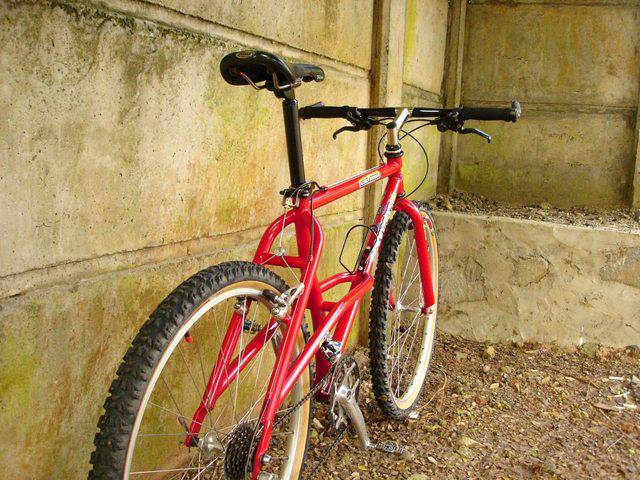

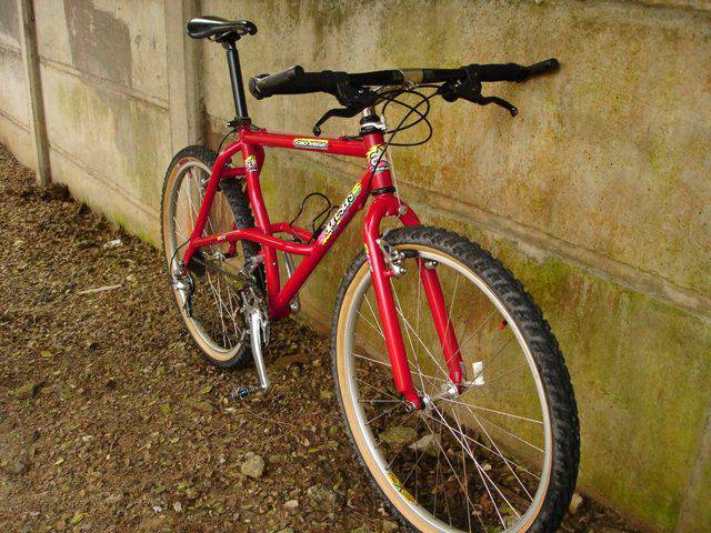

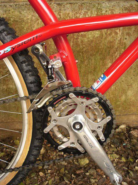

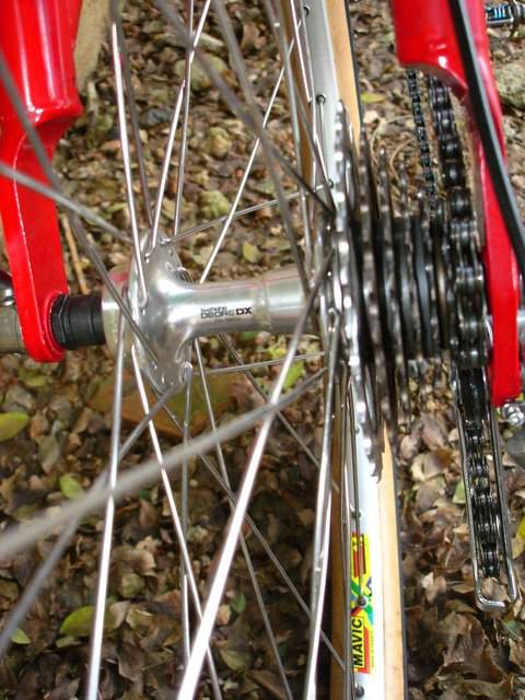

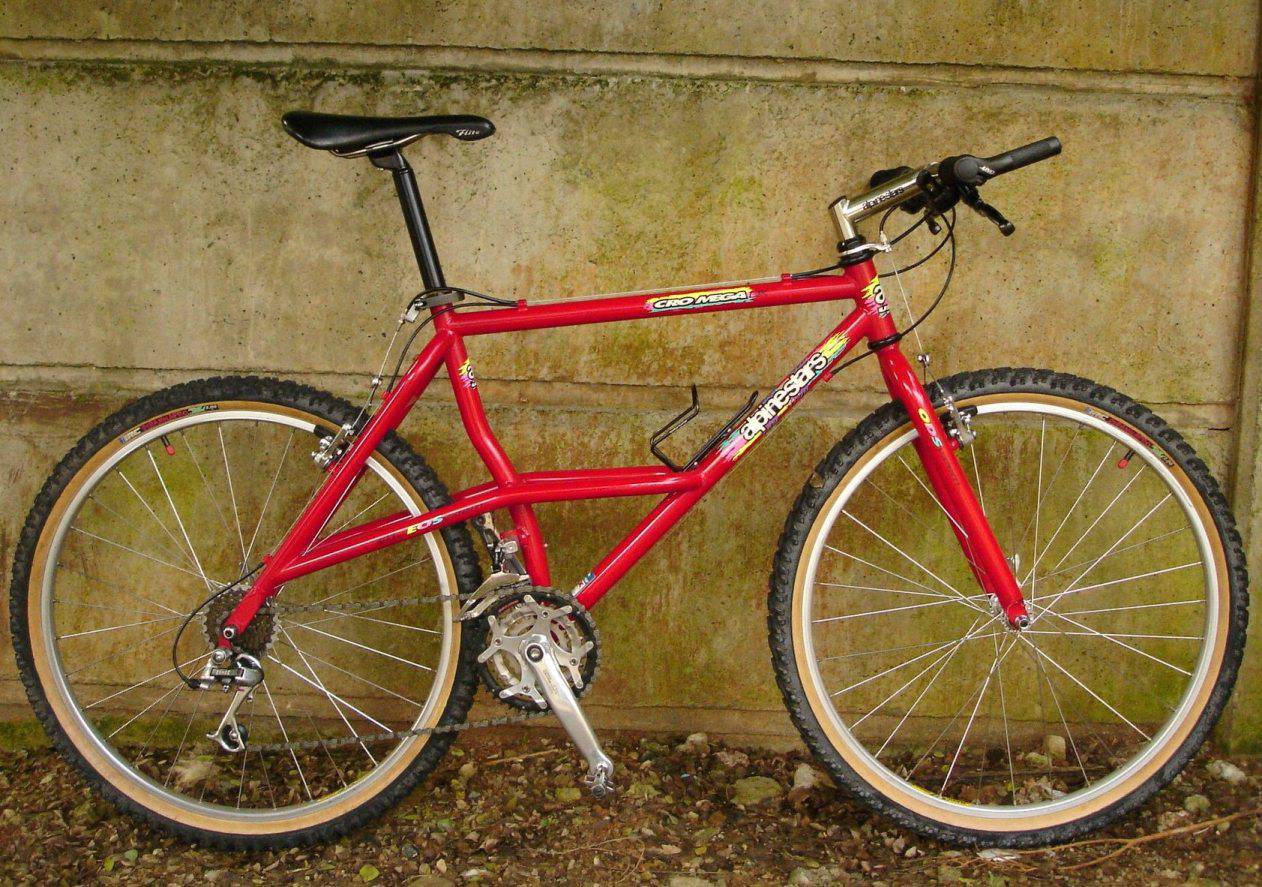

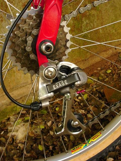

This is my first project since hooked up with VRC world, it's been done in 21 days (30 Jan - 20 Feb 2010), almost all parts including frame and fork I got in NOS condition except saddle and pedal. I was very happy to this achievement, since mountainbiking has been popular in my country for the last decade, it such not an easy things to do.
Spec details :

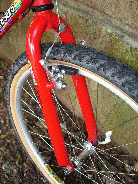

Frame n fork Alpinestars Cromega DX 1992 (NOS)

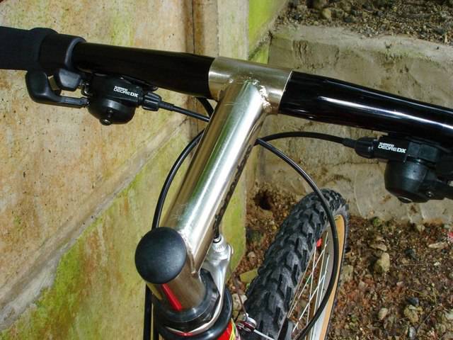

Shifter combo DX ST-M071 (NOS)
Low Profile cantilever brakes DX BR-M650 (NOS)
Chain Shimano HG70 7 speed (NOS)
FD LX 400 brace on (NOS)
RD Shimano Exage (NOS)
Cassete 11-28 LX HG50 7 speed (NOS)
Crankset LX M569 (NOS)
Bottom Bracket Neco 68 x 110 (New)
Rim Mavic M231 PSP (NOS)
Hub Deore DX HB-FH M650 (NOS)
Asahi Spokes (NOS)

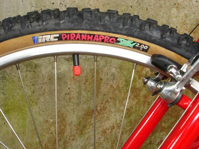

Tires IRC Piranha Pro F+R 2.0 (NOS)
Tubes Kenda Superlite (New)

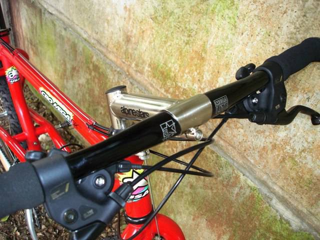

Stem Alpinestars Cromo 135 mm, 5 deg rise (NOS)
Handlebar Alpinestars Mega Lite (NOS)
Seat post Noname alloy 29.4 mm (NOS)
Bar-ends Uno Classic (New)
Velo Foam Grip (New)
Evo Headset steel w/ treadset (NOS)
Cable Stop Canti F/R alloy (NOS)
USED:
Saddle Flite Ti Selle Italia
Crank Brothers Egg Beater SL
Enjoy the pictures.......
Next project: DB Apex, Ritchey P21

I've been testing in off and on road, climb and down hilling for the last 4 week ends, feels great in handling, never feel like this when you hammered in aluminum, it's my first cromoly by the way.
This week end I'm participating in Up Hill Race Competition, a local championship series, absolutely use my Alpinestars instead of my modern 2009 Trek 9500 series , we'll see what happens... :D
