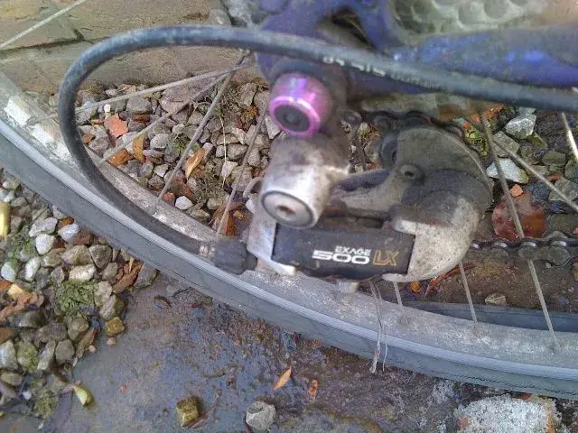

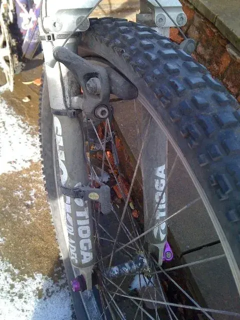

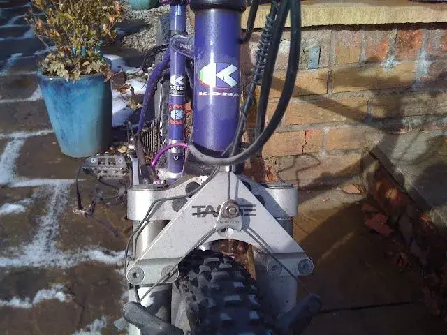

Anyway. I found my dad's old '92 Lava Dome in the garage and thought I would post it up here to see what people think of it. I'll be honest. it's been sat there for years and not got used at all. Would it be worth me doing it up?
Excuse the mess that it is in. I will try and get it cleaned up over the next week and post some more pics.

Welcome.
Get to Halfords, get some Muc-Off, clean the bike and then enjoy it :wink:
Under all the dust and grease it looks quite tidy!

Would it be worth taking the whole thing apart then to give it a good clean?
Also, I never knew much about the shocks that are on it. I presume they are knackered as they don't move! Any advice?
Also (sorry for all the questions) would it be worth upgrading brakes or will this detract from the retro cool! :)

I need some help with the forks/gears please.
I have some project 2’s off my old ’98 Lava Dome, found them last night so want to fit them to this as the current shocks are knackered. Would it be possible to do this. I’m a complete novice at this bike building stuff! I have a leisure lakes nearby, is the safe bet to take it to them?
Gears – Is it possible to change my thumb shifters (deore LX I think) to some rapid fire ones and then change the cables. Is it that simple?
I imagine that the Shockblades can't be repaired as you can't get replacement elastomers.
The easiest fix would be if your dad still has the original 1992 Project 2 that came with the bike. If that is lost then you could use the 98 P2, but it isn't totally simple, as it has an ahead steerer so you might need to replace the threaded headset and the quill stem with ahead items.
Another option would be to convert the 98 P2 to threaded. You don't say what size it is, but it looks from the photos as though the bike may be a size 16 with an 11cm head tube? In which case for a threaded fork it needs a c14cm steerer tube. As the 98 P2 has a steel steerer, it will take a thread, so it would just be a matter of getting a decent bike shop to cut the ahead steerer down to 14cm and cut a thread in it.
Whether Leisure Lakes is the kind of place to take it, I wouldn't know. I would think a small independent with a competent proprietor would be cheaper and do better work.
I should say that the 98 P2 is slightly longer than a 92 P2, so not a perfect match, but TBH you'd hardly notice it and you just want to get going. I think threading the 98 P2 may be the best option, and cheaper than replacing the headset and stem (unless of course the headset is shot anyway, in which case that changes the equation).
