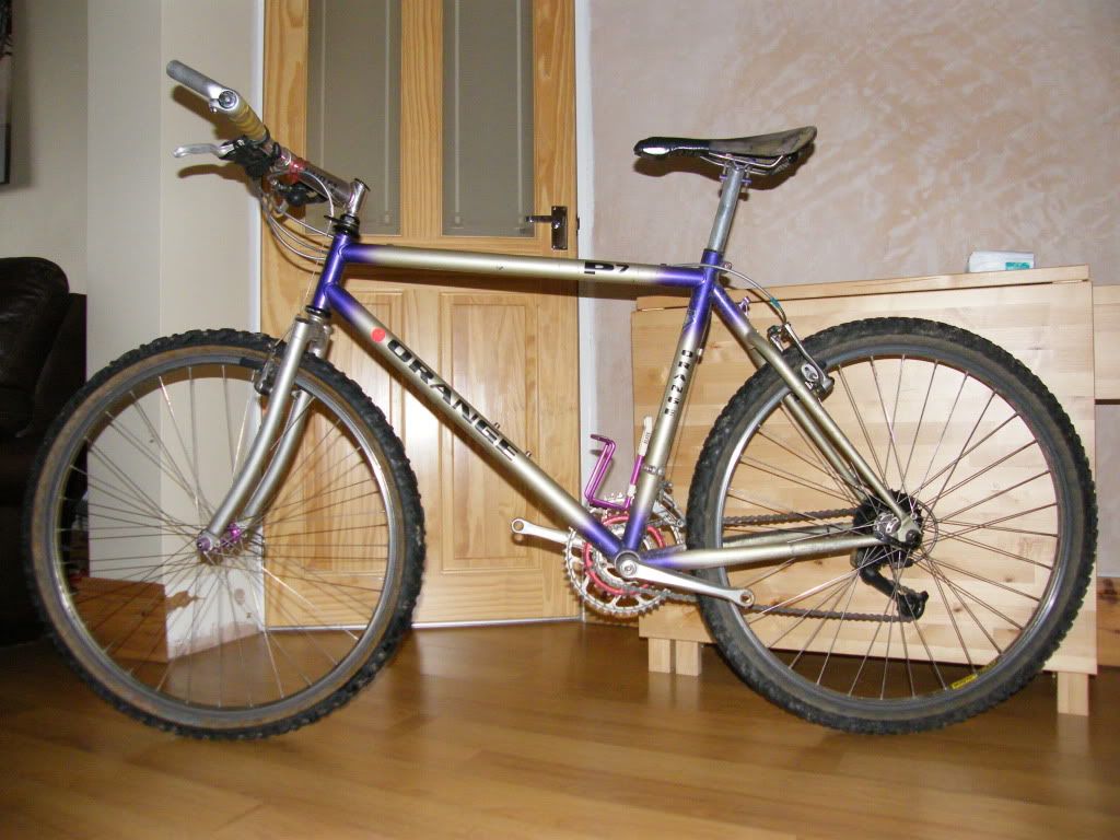

New here so hello everyone! Can't believe I stumbled upon this forum only recently when it has been around for so long. Cracking site, brought back lots of memories.
Anyway, I've got an old P7 that I've had since I was a teenager, bought the frame out of my paper round money and transfered upgraded parts from my previous bike. I bought a Scott Genius MC20 a few years ago and gave the P7 to a mate of mine to "look after" thinking I wouldn't need it again. However, I have since become a dad and the old middle age spread is starting to appear slowly but surely so I thought I'd get the old girl back in shape and turn her into a commuter to keep in shape......so that's the plan. It had a XT levers, mechs and V brakes when we parted company, now got a mish mash of cheaper rubbish on it so if anyone has got some nice XT or XTR bits and bobs to offer, gis a shout.
I,ve attached a pic. Should have taken this from the drive side but the cameras back in it's box now so can't be bothered. Frame number is A3094903, not sure what year this is? Would like to know.
I will post a spec list later, nothing to get excited about at the mo though.
Over and out, VB.

I think we've established with a fair degree of certainty that A3094903 means the frame was built in Sept 93 (A = where it was built, 3 = 1993, 09 = Sept), which in turn means that it's a 94 model. i.e., even though Orange were always a bit more all over the place than the big brands, the P7 was basically new for the 94 model range and the first ones might have been available before Christmas of 93. So they would have built the first P7s if anything before Sept 93, bearing in mind it needed to be painted, have parts hung on it, travel to the other side of the planet and be distributed to South Wales before you could have a chance of buying it. Which all takes time.

OK. Here she is......
http://s764.photobucket.com/albums/xx287/aberamanboy/?action=view&current=A3094903.jpg
Still not sure how to upload pics directly onto the forum, any tips welcome.
